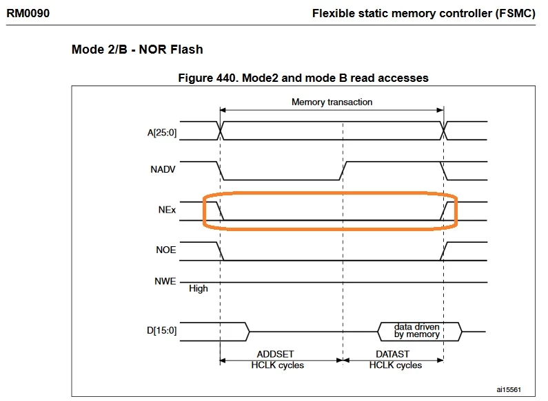

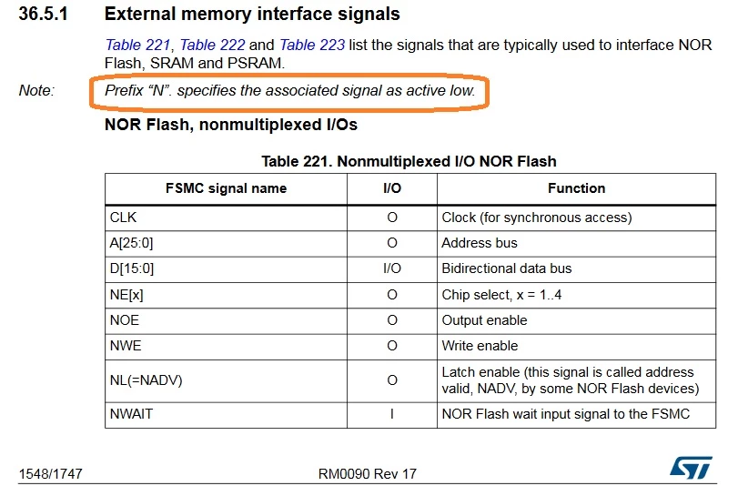

    Do you mean the NEx signals are active low? Thanks for the tip, but I would like to see a reference to that in the datasheet or reference manual of the device.
    So, there's a big chance to work out of the box, without extra logic? I believe it's worth a try. At least, if it didn't work, I guess I won't have problem accessing the first 64MB space of the M29EW flash chip.
    You might want to look at the RM then.

    Mr. Clive, you are our best reference of information over here. I just wanted you to show me where it was covered in the RM as I couldn't find it.
    Anyways, I hope you bear with me a little bit and explain it with a bit more of details. From the M29EW datasheet, it seems the A[26:0] address inputs are ACTIVE HIGH. When write takes place on the top half (second 64MB sub-bank), FMC_NE1 goes high and this applies to A25 of the M29EW? Now, CE# is ACTIVE LOW for the M29EW. I can see now why AND is required on a pair of NEx signals, but I'm still confused regarding the "reconstructing" of the address bits as you suggested, and which goes to which?

    Review the state of the pins during the bus transaction. Apply "logic". Remember FSMC_NE1 and FSMC_NE2 will ONLY be LOW during active accesses to the NOR, the entirety of the rest of time they will be HIGH. Only ONE will be LOW at a time.
    You don't provide a datasheet or part# for the specific part you're using, but I'm assuming an 16-bit wide device (D0..D15) with address (A0..A25) describing 128MB in total. And in this case you'd connect A25 with FSMC_NE1, because FSMC_NE1 will be ZERO during access to the lower 64M bank, and HIGH when FSMC_NE2 is LOW for the second 64M bank.
