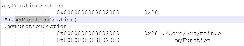

this image is my .map file for my project.
I am try to jump 0x8002000 address my project  shown ,
this output. so kindly help to me.

Vector tables need to be on 512-byte boundaries.
They are tables of addresses, not code.
Thr function pointer needs to be odd, per how the CMx processor indicates 16-bit Thumb code.
Have a working/reporting HardFault_Handler so you know it got there.
Learn to use the debugger so you can step the code and understand behaviour and failure.

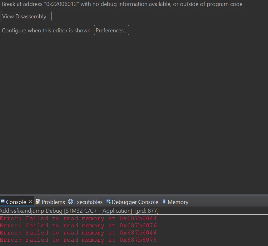

I am try below  mentioned method in way Hardfaulthandler error is happend.
kindly help to me. I am struggling  past 4 days .
