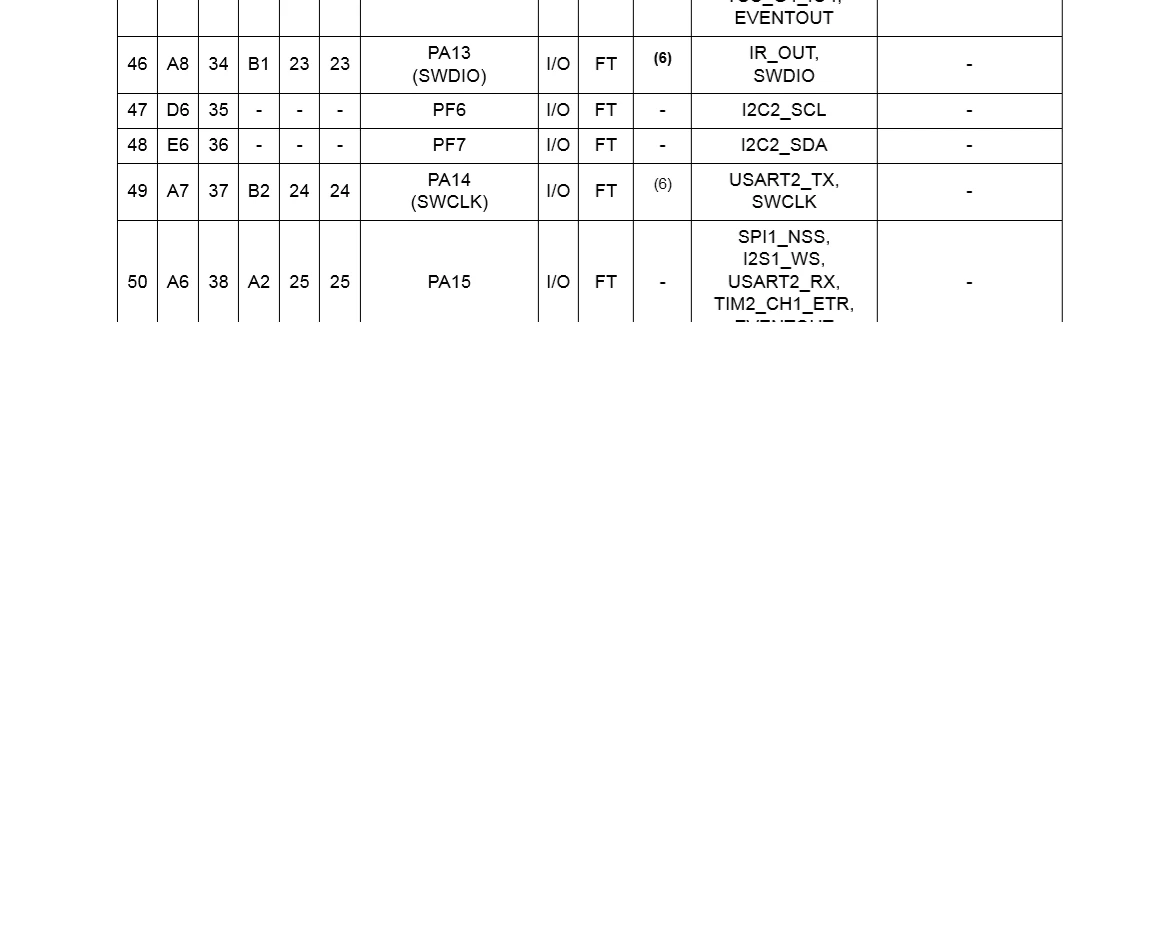

hai,
i am designing using STM32F051R4T6TR.I have configured port F for I2C but couldnt find that in the additional functions list in datasheet of the ic found on the last page.I found the additional function list of both PORT A and B in the datasheet but couldnt find one for PORT C and Port F.Please help me with this issue.I am in urgent need of the details regarding this.

    Look more thoroughly.
    The datasheet list is ordered by package pin numbers, not by port name/number. You need to collect the columns for all related port pins yourself.

    Thanks Avatar,
    Actually there is only one I2c in the controller even though two are being specified in the pin definition section.
