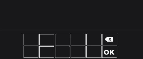

Hi, I've created a custom keyboard and so far all works good. I've just a problem: I want to use an OK button on the keyboard to copy the text edited to a text area in an other screen. I'm able to go to the other screen but when i do the second part of my goal, I've got errors. I think the problem is in the function getBuffer.
-This is the part in customkeyboard.cpp
void CustomKeyboard::okPressedHandler()
getBuffer(); // function to save the actual entered text
application().gotoScreen01ScreenNoTransition(); // if i use only this line the code work to change screeen
-Part in customkeyboard.hpp
virtual void getBuffer()
// implemented in screen02_00View.cpp
-Part in the screen where the keyboard is defined
extern Unicode::UnicodeChar keyboardBuffer[10];
void Screen02_00View::getBuffer() // added to manage the entered text from temperature keyboard
Unicode::UnicodeChar* buff = keyboard.getBuffer();
Unicode::strncpy(keyboardBuffer, buff, Unicode::strlen(buff) + 1);
-Part in screen.hpp
virtual void getBuffer(); //added to manage the keyboard entered text
-Part in the screen where I want to go when i pressed ok button and where i want to save the text edited
Unicode::UnicodeChar keyboardBuffer[10]; // at the beginning of the code
void Screen01View::updateScreen() // I've defined updateScreen from touchGFX
if(Unicode::strlen(keyboardBuffer) > 0)
memset(&BakeText3Buffer, 0, BAKETEXT3_SIZE);
Unicode::strncpy(BakeText3Buffer, keyboardBuffer, BAKETEXT3_SIZE - 1);
BakeText3Buffer[BAKETEXT3_SIZE-1] = '\0'; // make sure last index is null
BakeText3.invalidate();
Part in the screen01.hpp
virtual void updateScreen();
Could you please help me?
Thank you
This is my keyboard:0693W000005BHAKQA4.png

    As the error mentions, CustomKeyboard::getBuffer() is undefined. It is because CustomKeyboard does not have the getBuffer() function. It's the Keyboard class that has it, not CustomKeyboard ;) CustomKeyboard does not inherit from the Keyboard class but only has a Keyboard object as an attribute.
    So you need to define a getBuffer() function in your CustomKeyboard class to be able to call it from your ScreenView.
    Something like :
    Unicode::UnicodeChar* CustomKeyboard::getBuffer()
     return keyboard.getBuffer();
    Don't forget to declare it in the .hpp file as well.
    The fact that both your CustomKeyboard and Keyboard variable have the same name is misleading. I suggest you to change your CustomKeyboard variable name to customKeyboard to avoid mixing them.

    The error is the following:
    TouchGFX/build/STM32F746-DISCO/TouchGFX/gui/src/screen02_00_screen/Screen02_00View.o: In function `Screen02_00View::getBuffer()':
       /TouchGFX/gui/src/screen02_00_screen/Screen02_00View.cpp:28: undefined reference to `CustomKeyboard::getBuffer()'
