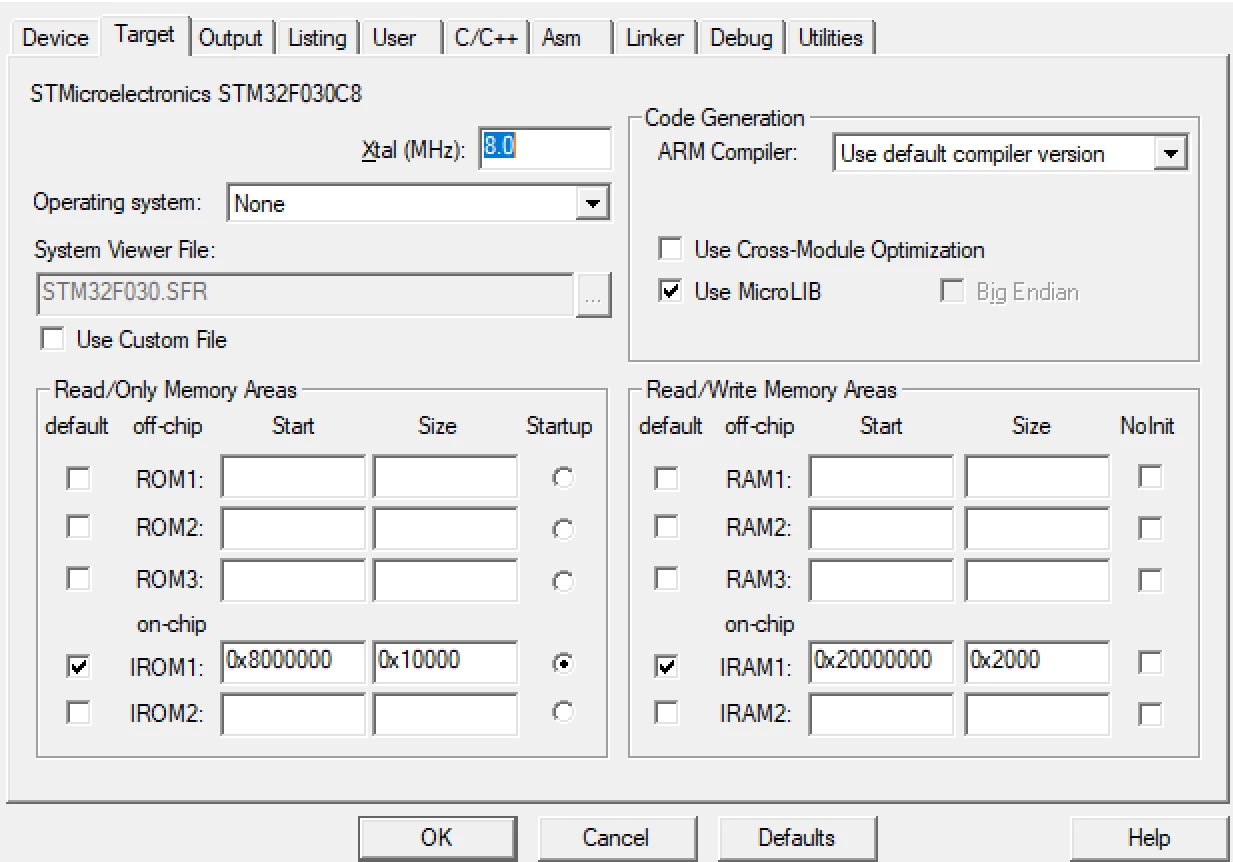

MM..1
July 30, 2022
Is your Keul free? If yes you are over limit
MM..1
July 30, 2022
Ala
AlaAuthor
Senior
July 31, 2022
yes it is. how should I change it?
