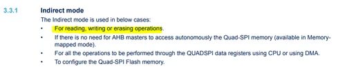

I read the documents and found that there is a possibility of extending the RAM with Quad-SPI, but it is not clear to me when it says, "Can't be written to the memory when it is configured memory-mapped code execution mode".

For the QUADSPI interface, in memory-mapped mode, the external flash memory is seen as an internal memory but with some latency during accesses. Only read operations are allowed to the external flash memory in this mode. as mentioned in RM0433 section 23.3.12 QUADSPI use.
The indirect mode mode support read and write operations.
For more information I advise you to take a look at Quad-SPI interface on STM32 microcontrollers and microprocessors - Application note
For the QUADSPI interface, the write operation is not supported in memory mapped mode.
For the OCTOSPI interface the write operation is supported in memory mapped mode as mentioned in Getting started with Octo-SPI, Hexadeca-SPI, and XSPI Interface on STM32 MCUs - Application note
The QSPI examples can help you to write and read data from external memory.

As described very well by Alex from APMemory:
https://community.st.com/t5/stm32-mcus-products/where-is-it-documented-that-stm32h7-can-only-read-memory-mapped/m-p/598460/highlight/true#M225010
There are some limitations on using QSPI /OSPI RAM chips with the STM32H7xx series, but when You use the right device it is working.
Martin

Pretty sure the H743 isn't supporting any memory mapped writes on Hyper RAM, etc.
Minimal 16-bit wide SDRAM probably going to soak up 30 or so pins.
If you want 128MB of RAM you're going to need to re-evaluate your part choice and foot-print to accommodate the memory and the pin escape for other peripherals.
The FMC having the least amount of choices for pin remapping.
Probably going to need to look at H72x/H73x or H7Ax/H7Bx devices with OCTOSPI
Perhaps PSRAM or whatever we're calling the multiplex RAM option. Although the capacity suggests SDRAM as the most viable.

Yes Tesla DeLorean is right, I had not realized that the STM32H74x familiy has only the "old" QSPI controller.
Sorry for that.
