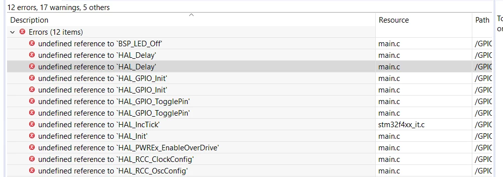

    After I try to add some path into the example project, I got some progress, but I got the following compiler issue:
    How can I fix it?

    Add library source files to the project with the code for those functions in them?
    STM32Cube_FW_F4_V1.21.0\Drivers\STM32F4xx_HAL_Driver\Src\stm32f4xx_hal.c
    STM32Cube_FW_F4_V1.21.0\Drivers\STM32F4xx_HAL_Driver\Src\stm32f4xx_hal_gpio.c
    etc
    Your project should have a configuration file pulling in the include files
    stm32f4xx_hal_conf.h
    And the define
    USE_HAL_DRIVER
    How can I get this configuration file? I import the fw folder into truestudio,  I can't imagine how difficult to start even one simple example using truestudio.

    Use CubeMX to create a project for TrueStudio. You have from the start a compilable project with all the drivers included. Then it is really easy to add your code. This is the best method for HAL based projects. Even regarding the examples you want to import, just recreate them in CubeMX.
