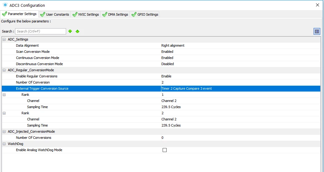

I'm using a STM32F103 MCU and I want to sample two signals with ADC3.
I also want to sample the signals at 1kHz and to do that I think to use:
  • ADC3 with 2 channels
  • Trigger the ADC with a Timer running @ 1kHz
  • Use the DMA to transfer the samples

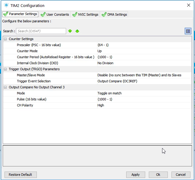

With Cube32Mx, I configure the ADC3 to be triggered by TImer2 Caputre Compare 3 event.
My problem is: I don't know ho to configure the timer to generate the trigger for ADC3.
These are my settings for ADC3
These are my settings for Timer2:

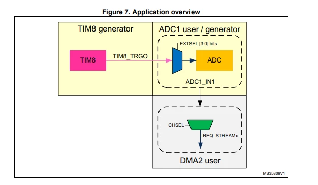

http://www.st.com/content/ccc/resource/technical/document/application_note/59/ed/30/07/55/76/4e/82/DM001549pdf/files/DM001549pdf/jcr:content/translations/en.DM001549pdf
application note you may find an example with snnipet of code about how to set up ADC1 to start single conversions every time TIM 8 overflows. Each time an end of conversion occurs the DMA transfers the converted data from the ADC to memory:
-Nesrine-
