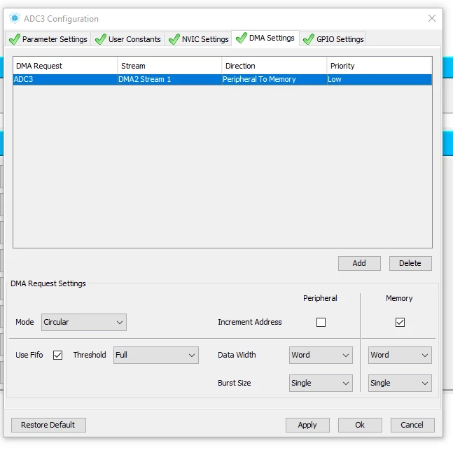

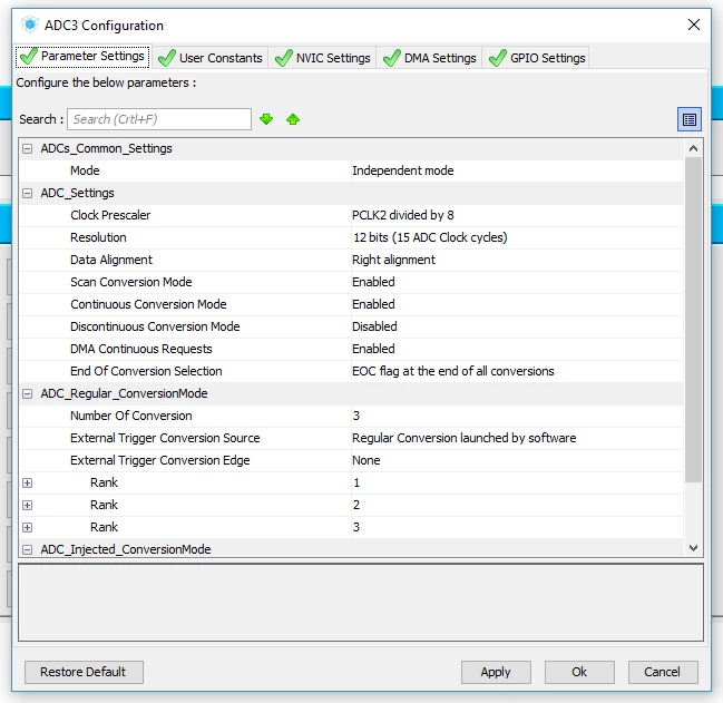

I'm using STM32F427ZI with FreeRTOS.
I am configuring both ADC1 and ADC3 to run using DMA, but I'm getting different behavior between them.
This is the configuration for ADC3, ADC1 is configuration the same:
ADC1 is configured to use DMA2 Stream 0, and ADC3 is configured to use DMA2 Stream 1.
This is configuration of DMA for ADC3. The configuration is the same for the DMA for ADC1.
After calling all init functions of the ADC and the DMA, I call the ADC Start DMA function:
result = HAL_ADC_Start_DMA(&hadc3, (uint32_t*)(adc3SamplesArray), 3);
If I call the function for ADC1, the DMA performs as expected and the callback is called.
If I call the function for ADC3, no call back is called, and the DMA doesn't seem to be doing anything.
What am I missing?

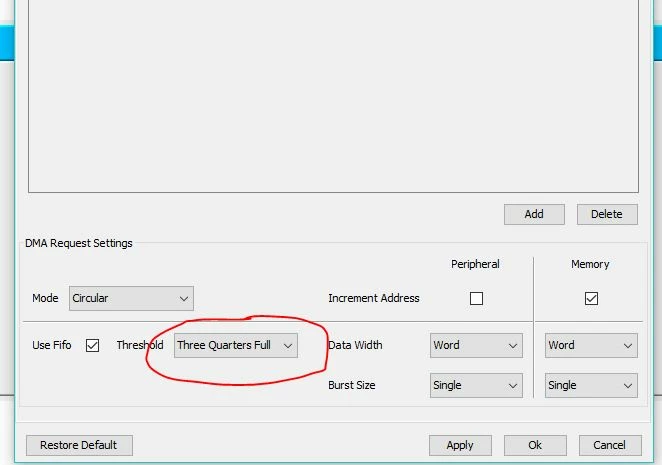

Vangelis Fortounas
Jul 30, 2017 12:01 PM UTC
Posted on July 30, 2017 at 14:01
Hello!
I can reproduce your error..
To solve it  put 3/ threshold fifo at both dma channels (or less, depending your config).
Handle DMA overruns by implement HAL_ADC_ErrorCallback.

Maor Avni
Maor AvniAuthor
Jul 30, 2017 3:33 PM UTC
Posted on July 30, 2017 at 15:33
Thanks. That did the trick.
