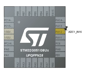

ADC1_IN16 (no mode)
I begin a new project I want to use the PA12 as a ADC input. But the pin is orange and I am unable to activate the mode or channel of the ADC.
What is the explanation behind it? How do you explain it?
Thanks a lot to all.

Mar 20, 2025 11:11 AM UTC
There is a trick, see Solved: STM32G030K6T6 - can not configure ADC1_IN16 @ PA12 - STMicroelectronics Community
https://community.st.com/t5/stm32cubemx-mcus/stm32g030k6t6-can-not-configure-adc1-in16-pa12/td-p/64113
enable ADC IN0 temporarily.
change sequencer settings in ADC parameters tab,
enable ADC1_IN16 on PA12
disable ADC IN0
hth

Mar 20, 2025 11:12 AM UTC
It worked.
