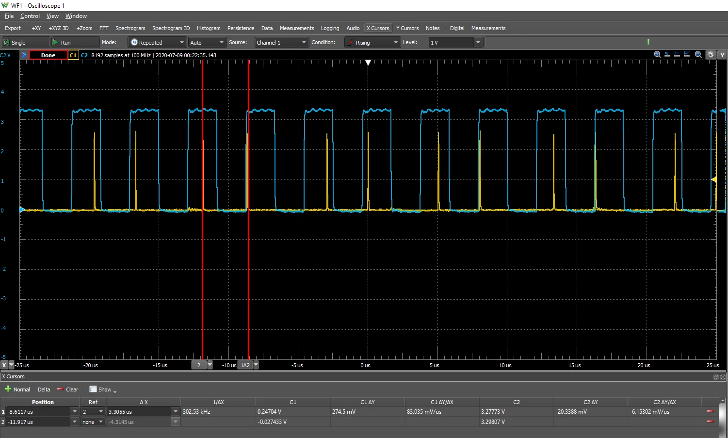

Hi
I've configured two ADC 1 and ADC5 in independend mode with DMA and triggered by master compare from HRTIMER.
I have two problems
First. When I have started two ADCs by HAL_ADC_Start_DMA one by one
my code freeze on debug after this, but when I set the one GPIO to toggle in HAL_ADC_ConvCpltCallback I see that converters are working
even they dont work when I use two diffrent compare registers in HRTIMER with two diffrent values to trigger them out of phase
With one ADC at once code works perfectly and I can debug code normally
Second issue is that i see that GPIO toggle (BSRR used) in HAL_ADC_ConvCpltCallback is not in sync with HRTIMER edges and it varies from cycle to cycle. (blue is PWM from HRTIMER, yellow is GPIO toggle after ADC callback)
10 replies
Jul 9, 2020 1:05 AM UTC
It looks like the period between triggers is around a little under 5us. So you're generating the HAL_ADC_ConvCpltCallback for each conversion at a rate of 200kHz. It's possible the CPU just can't keep up.
Slow the triggers down by a factor of 10 and try again.

I'm not saying the CPU isn't able to achieve what you want. I'm suggesting lowering the frequency temporarily (1) to rule out the possibility that the interrupt routine is completely occupying the cpu and (2) to provide more information on when HAL_ADC_ConvCpltCallback gets called in relation to when it's triggered.

I have created this code to measure lag between ADC1 and ADC2 callback (Gpio toggle in ADC1 and ADC2). The lag is 2us = 500Khz so 240khz shoudnt be a problem but I have measured that approx 150khz is max when callbacks are not overlaping.
I can set for the LLC stage the postscaler to the ADC to lower the ADC sampling but it not solve the whole problem beacuse ADC from LLC Timer (since LLC stage is frequency variable) could overlap with DCAC (50khz fixed switching) stage timer i.e when LLC=100, 150, 200 khz and so on.

That IMO doesn't tell you, what's the duration of the ISR.
