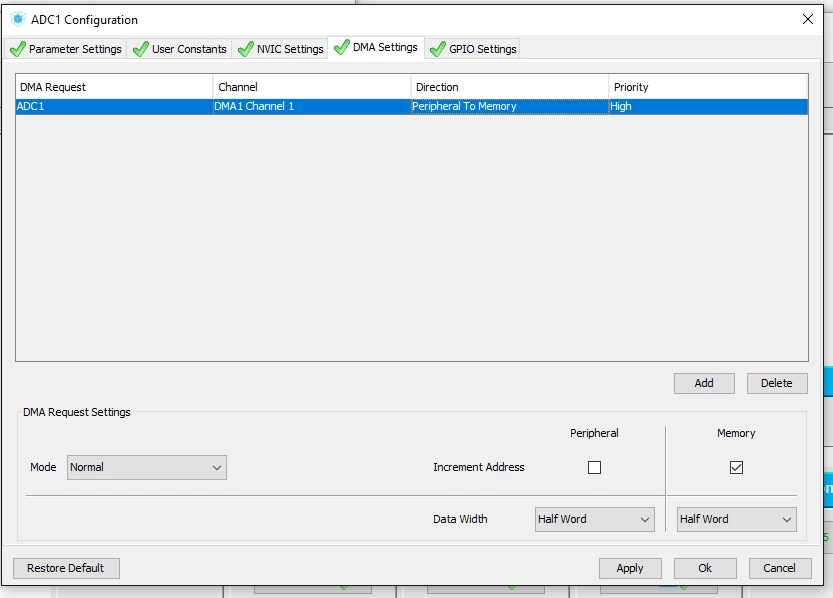

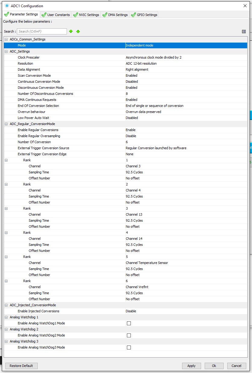

I wish to use ADC1 to measure 6 channels and to have the results DMAd into memory.
I am using CubeMX V4.21 and I think that I have set the parameters up correctly
(See attached screen snip ADC_DMA_1 to 3.PNG)
This sequence is to be triggered by S/W to run once, terminate and then run again sometime later.
(This is in a loop for testing at the moment).
The DMA happens as I am seeing the ADC readings appear in the adc1_data array and I get the DMA half complete interrupt handler being called but not the end of sequence interrupt.
What am I doing wrong please.....

    as in your second png, dma packet size is half wold, 16bit,
    You can't use
    ADC1_BUFFER_SIZE_IN_BYTES;
    Probably, it's
    #define ADC_CHANNEL_CNT   6
    status = HAL_ADC_Start_DMA(&hadc1, (uint32_t *)adc1_data, ADC_CHANNEL_CNT)
    by the way, if you check you adc buffer, you'll probably see those 6 adc data already lying there.
    Good Luck!

    Andy Pevy
    Andy PevyAuthor
    Jun 9, 2017 10:29 AM UTC
    Posted on June 09, 2017 at 12:29
    Brilliant, that did the trick..
    Thanks for the answer.
