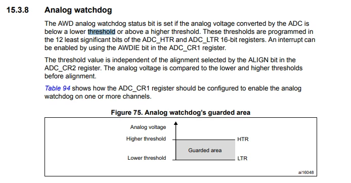

Hi everyone!
I want to read 2 channels with an ADC via DMA using circular buffer. So far so good. Now I want to use a watchdog for both channels when a certain threshold is reached. However, when the watchdog is triggered and I read the values in the DMA buffer, none of them are above the threshold, meaning they are probably old values.
So the question is: How do I get the ADC value that triggered the watchdog interrupt (values for all channels)?
I am using STM32F746 DISCO with CubeMX, CubeIDE.
Thanks!
Peter

Hi @PSmol.1​ ,
Can you check the higher and lower threshold of the analog watchdog ?
0693W00000UnEVQQA3.pngIf you get the analog watchdog interrupt, it means that the value is below the lower threshold or above the higher threshold value.
Please find attached the corresponding Reference Manual.

The lower threshold is 0, meaning it is a given that the upper threshold was triggered.
