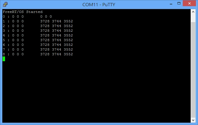

Dear all:
I have been using the STM32F4 Discovery for few weeks by exploring examples related to DMA and ADC (e.g.,ADC_Interleaved_DMAmode2,TripleADC_Interleaved_DMAmode2, etc). I tried to use these codes in FreeRTOS. The output is attached. It seems that the conversion is only done once and the values were never moved to the buffer through DMA. In FreeRTOS, the ADCtask is shown below. If I dont use DMA with ADC, then it works. Could anyone give some suggests?

while(1){
printf(''%d : %d %d %d\t'', i++, ADCTripleConvertedValue[0]&0xfff,
ADCTripleConvertedValue[1]&0xfff,
ADCTripleConvertedValue[2]&0xfff);
printf(''%d %d %d\n\r'', ADC_GetConversionValue(ADC1)&0xfff, ADC_GetConversionValue(ADC2)&0xfff, ADC_GetConversionValue(ADC3)&0xfff);

please show the DMA ISR
