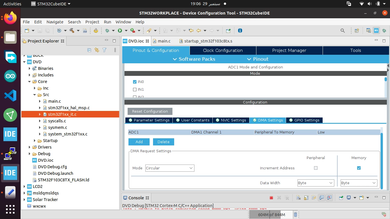

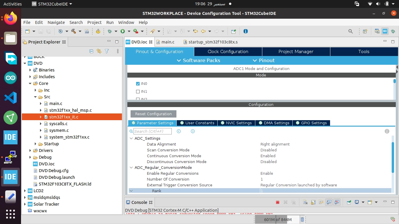

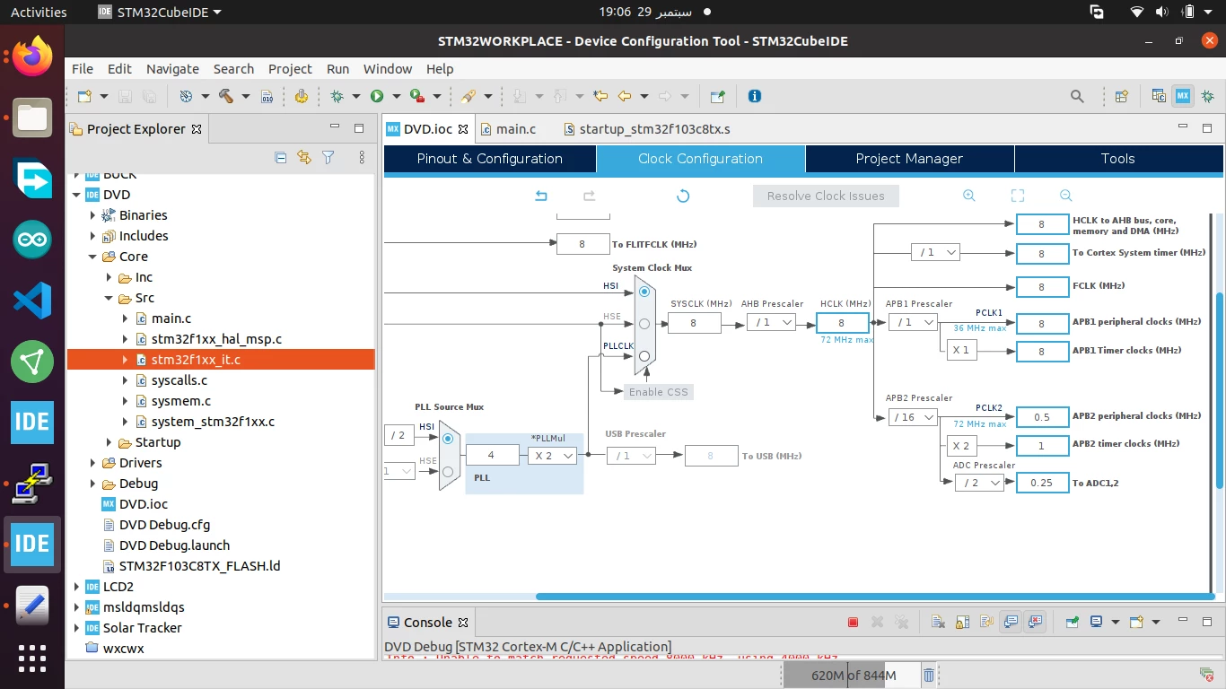

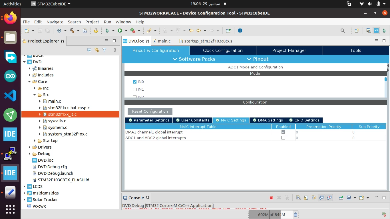

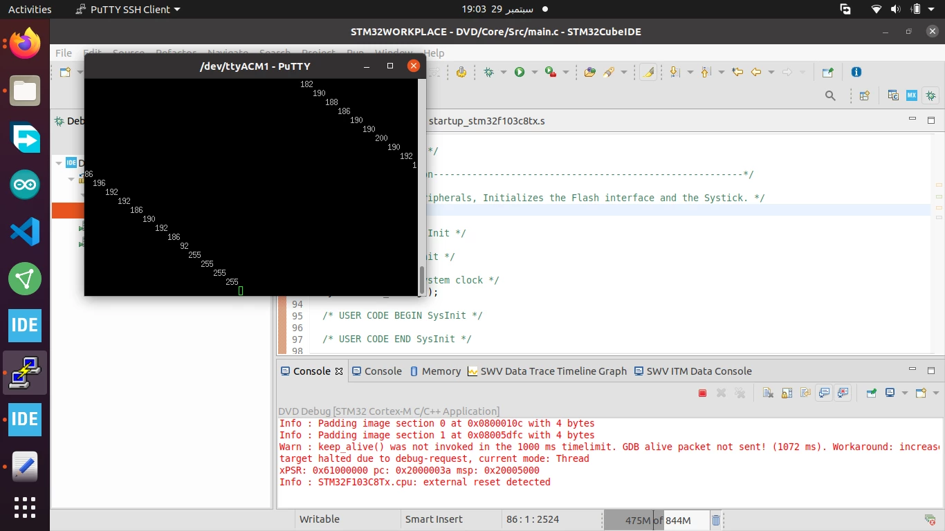

ADC(with DMA) doesn't work when I increase its frequency
This has been a reoccurring issue for me, whenever I raise the ADC frequency above 0.25MHZ the while loop gets interrupted, and when I use frequencies below that the ADC resolution drops to 8 bits for an unknown reason. Is there a way to fix this without having to use poll for conversion or IT?
note: I'm using cubeIDE.0693W00000FAuNaQAL.png0693W00000FAuHxQAL.png0693W00000FAuMXQA1.png0693W00000FAuMDQA1.png0693W00000FAuLLQA1.png

September 29, 2021
Trick would be to NOT interrupt after EVERY SAMPLE
At 250 KHz you've got a lot of time wasting interrupts/callbacks
Decimate the interrupt loading by taking 10, 100 or 1000 samples between callbacks

MM..1
September 29, 2021
In your code i see more troubles.
  1. DMA for one sample is possible , but waste DMA efectivity to zero.
  2. USART on 1200 baud and delay aproxim. your out to around 10 measured and reported samples from ADC úer second
  3. all other ADC measured is overwrited and skipped by DMA.
  4. your code now in real pool memory
HAbay.1
HAbay.1Author
September 29, 2021
How do I increase the number of samples per interrupt? Also UART doesn't really matter for my project it's just to show that the resolution drops.
