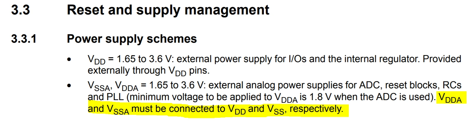

ADC(VDDA) Input Volatge
I am not quite sure about this.
I have a STM32L100 µC operating at 1.8V, the analog pin sees a 3.0V coming from a battery and I want to use the ADC to be able to monitor the voltage of the battery.
I plan to supply the VDDA Pin with 3.3V (the VRef+ is internally connected to VDDA).
My question: Is this allowed. Can I give the VDDA a different voltage than what the µC is operating with?
I read the datasheet but i did not quite see the relation between VDD and VDDA.

VDDA needs to be connected to VDD. It's in the datasheet.

Not a part I'm using, but other STM32 don't permit significant difference in VDD/VDDA
