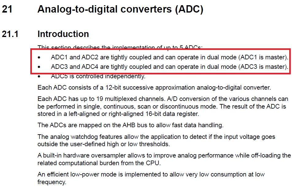

You need to refer to the reference manual RM0440 for that:
From ADC introduction:
The modes are described in the ADC section:

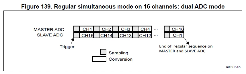

ADC1 and ADC2 can work together in Dual mode in specifically in "Regular simultaneous mode":
See figure 139:
Triple mode is not available on this product.

Lets say i want to measure 6 ADC input simultaneously.
Then i have to use 3 channels from ADC1 and rest 3 channels from ADC2.
I am using STM32G474VET3  (G4 series)
mƎALLEm
June 12, 2024
Again, "6 ADC input simultaneously." is not clear.
The simultaneous mode is described in the RM, you can measure only two channels at time T with two ADCs.

mƎALLEm
June 12, 2024
"Does is possible by ADC1 and ADC 2
Input 1 then input 2, Input 3 to ADC1
Input 4 then input 5 , Input 6 to ADC2"
This is not a simultaneous conversion. It's a done successively ... and can be done by 2 ADCs in DUAL mode.
I've already shared a figure from the RM that fits your needs ..
And simultaneous conversion is something else, that's why:
"This is very simple question " -> Sorry this is not a simple question .. You need to find the right words to describe what you need ..
