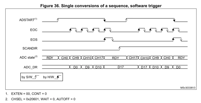

I think you are partially correct. If I increase the sample time to 19.5 ADC Clock cycles 2 EOC events happen for each EOS event. I think there should be 3 EOC events, see the diagram, but it's an improvement. Also the data register now holds the data corresponding to the last channel in the sequence which is nice.
Actually, when the WAIT bit is set, 3 EOC events happen for each EOS, so that definitely solved the issue.
0693W00000Uo1NuQAJ.pngHowever if there previously was not enough time in the interrupt routine to reset the EOC flag the OVERRUN flag should have been set by hardware. It wasn't since I checked that by also printing out the ISR register... Strange business
I guess I can solve the issue reliably by using WAIT, or implementing DMA for this. Cheers!

In any case 3 EOC events are generated but since the total interrupt handling time is now approx. > 2 x conversion time, you miss one event and the ISR is fired 2 times after the chage (was fired only once before).
