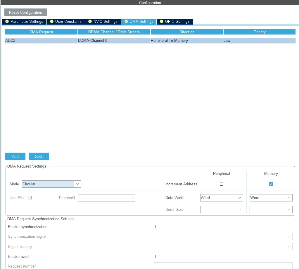

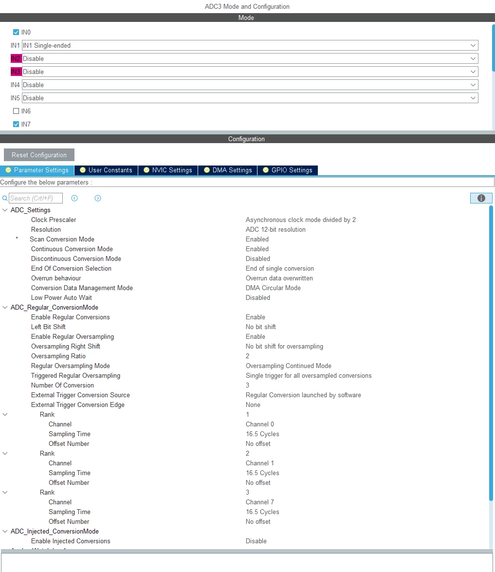

Dear all,
I am trying to read 3 ADCs channels using scan continuous mode and DMA with a STM32H7 (ADC3). Below the CubeMx settings + DMA.
In the main, before the While(1) loop I start the ADC with:
HAL_ADC_Start_DMA(&hadc3, (uint32_t*)adc_data, 3) ;
Where ADC_Values is uint32_t adc_data[3];
When I run the debugger, adc_data is always 0x0000.

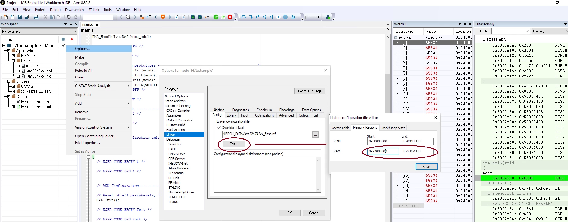

Imen GH
February 27, 2020
You should change the memory address, as shown in Figure (when using IAR)
 Please find attached the RM0433 Rev 6  (page 101, 128) link for more clarification
Regards
Nesrine.JLASSI
Visitor II
March 10, 2020
Hi all,
User have to do this update
define symbol __ICFEDIT_region_RAM_start__ = 0x24000000;
define symbol __ICFEDIT_region_RAM_end__ = 0x2407FFFF;
manually (in the stm32h743xx_flash.icf ) since linker file is not managed by STM32CubeMX (copied from the FW package).
Best regards,
Nesrine

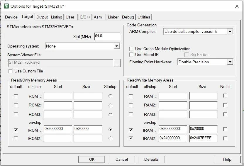

Dear @Nesrine.JLASSI​ , is this equivalent to setting the IRAM2 region in the target option in Keil ?
Mdi c
Mdi cAuthor
April 3, 2020

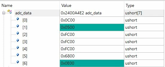

Hello @Nesrine.JLASSI​  and @Imen GH​ , modifying the IRAM2 in Keil did the trick. Now I can see the data being acquired by the MCU. However, I noticed that despite the ADC resolution is set to 16bits, I can only read 8bits since the the 8 LSBs are always 0, as shown in the debugger view below:
where :
uint16_t adc_data[7];
HAL_ADC_Start_DMA(&hadc1, (uint32_t*)adc_data, 7) ;
