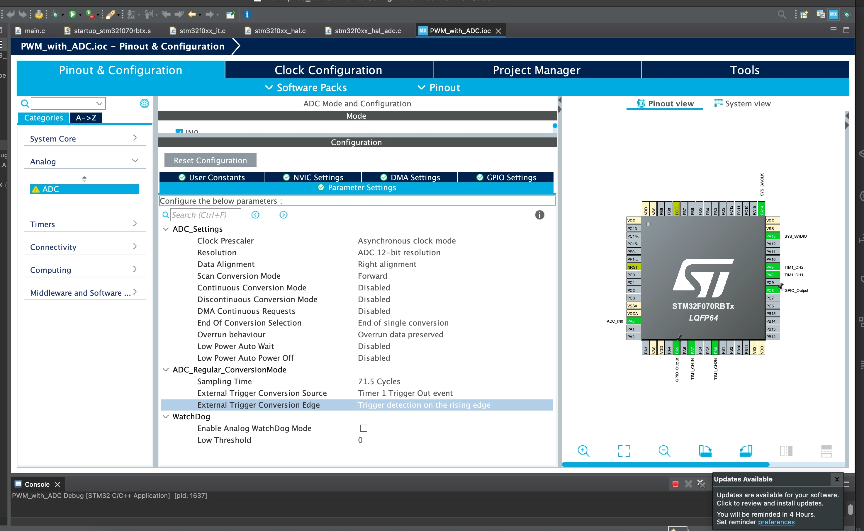

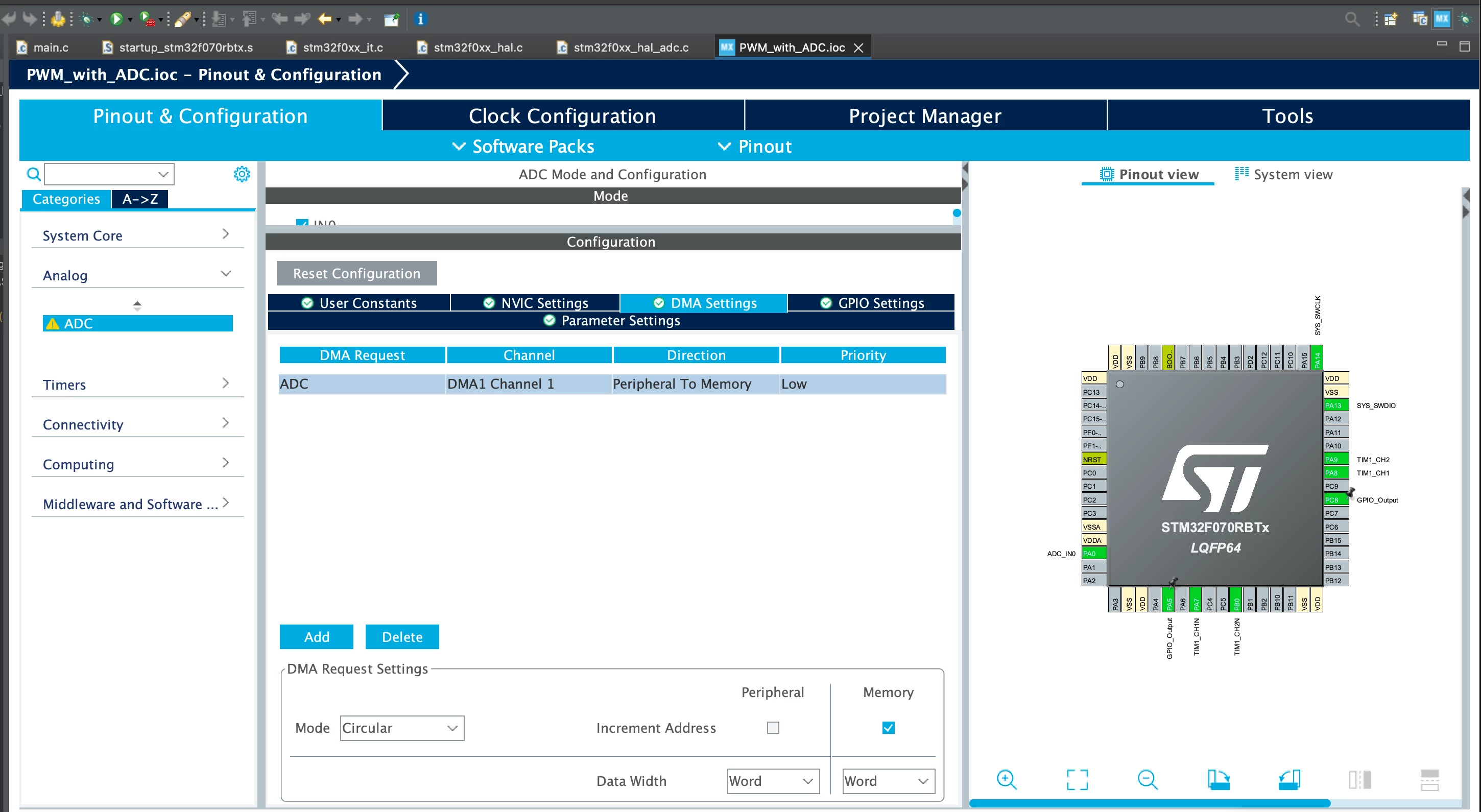

I turned of all you said but not sampling ADC
I have configured as follows
In DMA data width i tried Half word also

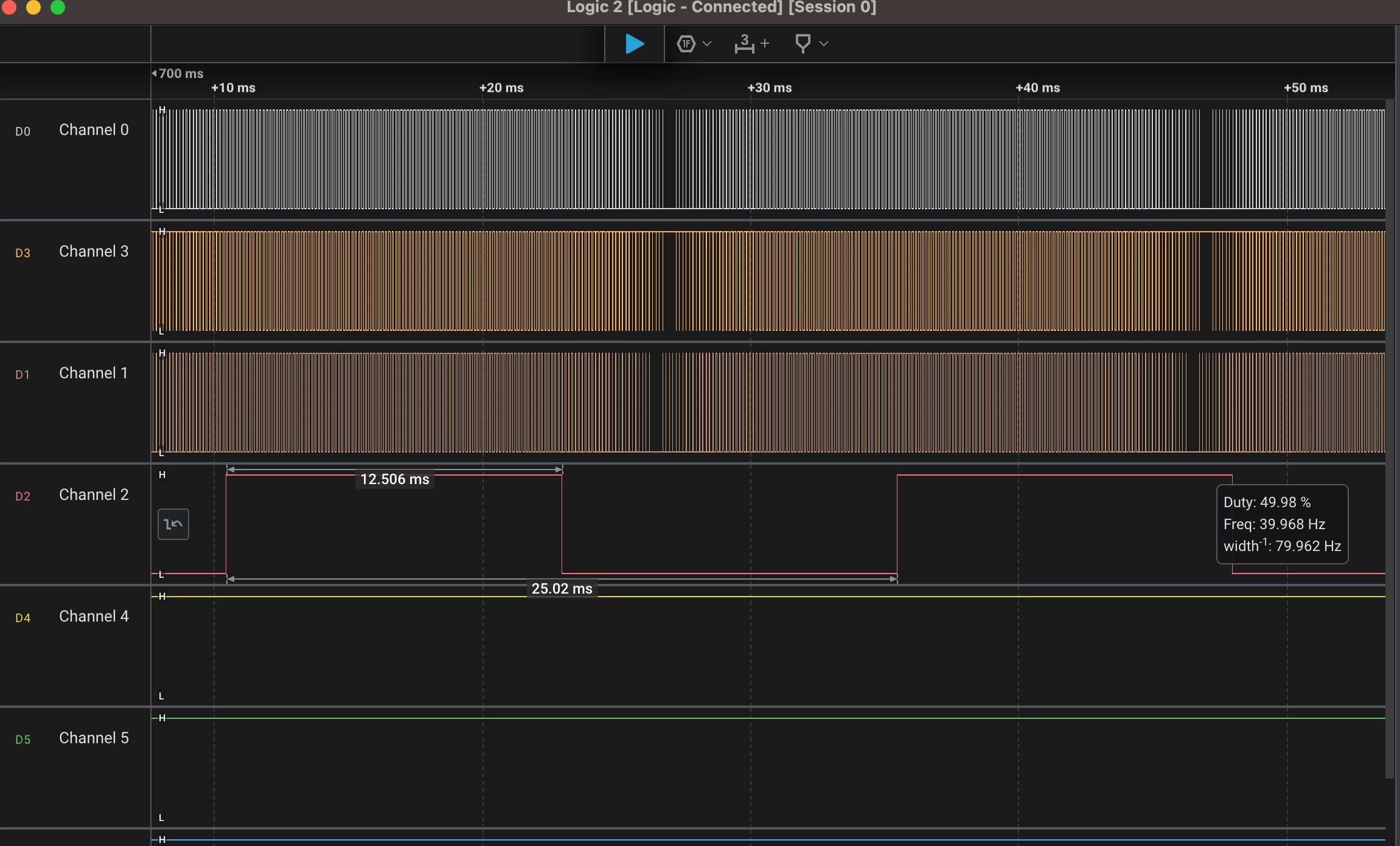

When I enable DMA contnious request the ADC is sample some of frquency as follows  12.506 ms second sample

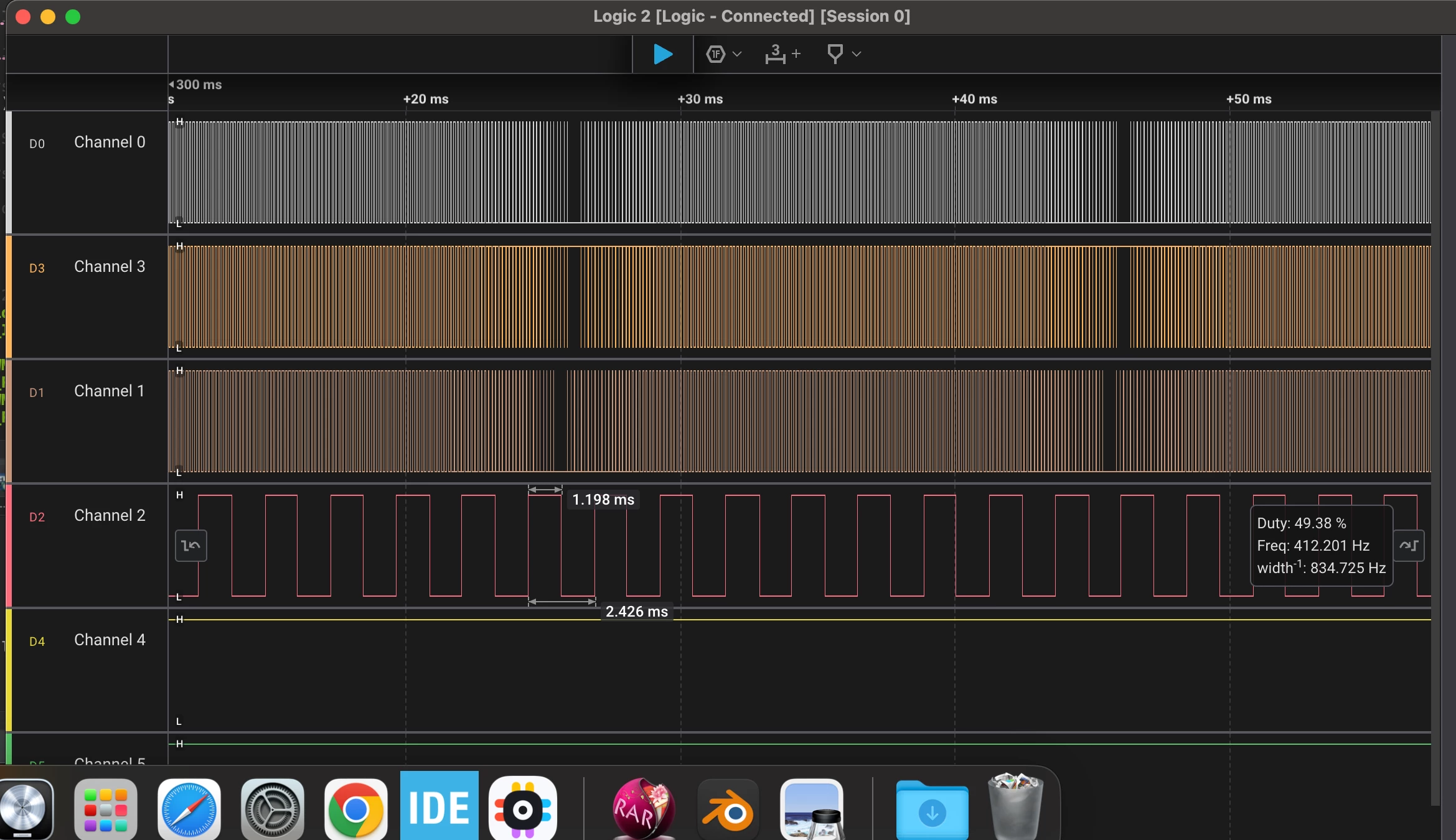

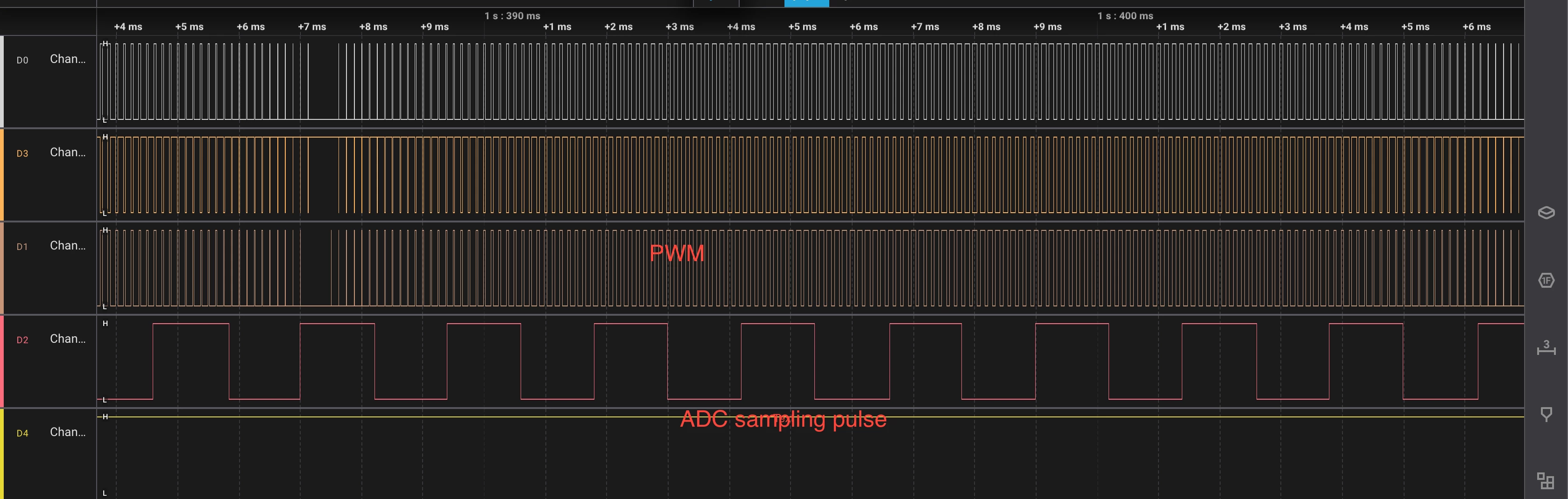

when i use conntinus DMA request + continous Conversion the following sampling getting
Please help me correct it ?
