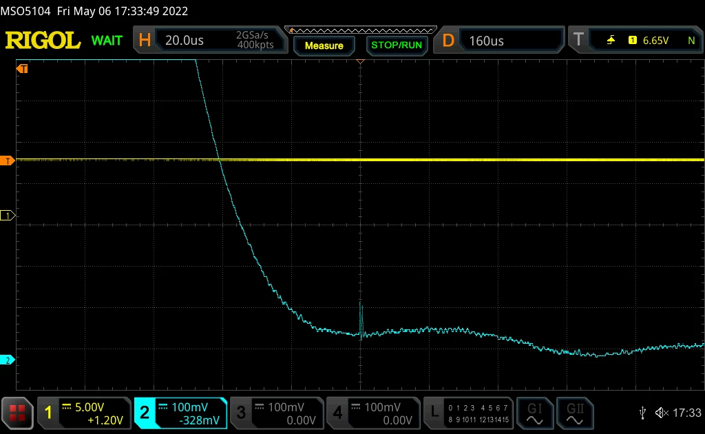

I have a reading problem with dmaWhen reading multi channel with ADC dma I need to know when to sample each channel. In the ADC input, I found a 2us transient in the oscilloscope output below. I considered this transient as adc sampling time and adjusted the delays. (I had to put 138us delay for 160us) are there any errors in my route?
Also, the transient contains 2 peaks, I couldn't understand where the second peak came from.
