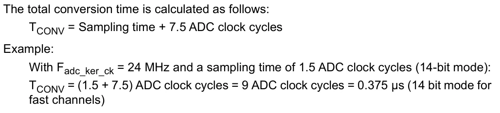

I use ADC3 on STM32H7, I need to know (and set) what is sampling frequency.
I use 3 channels in 16 bits.
What I tried to calculate?
1) Tconv_time = 8.5(setable)+8.5(fixed for 16 bits) = 17 ADC clock cycles = 17/30Mhz = 566 ns

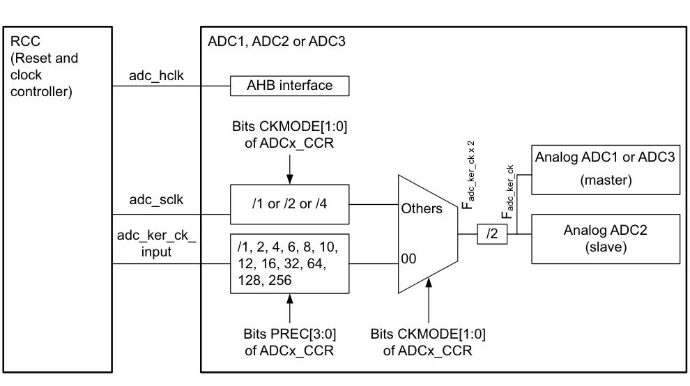

2) From this image I should have Fadc_ker_ck = 30 MHz, becase my CKMODE = 0b11, and adc_sclk = 480/2 = 240 MHz (HPRE=2) - so it is sys_clk/2
_legacyfs_online_stmicro_images_0693W00000blJ9dQAE.pngForm above the Tconv should be 17/30Mhz = 567 ns
What about sampling frequency? My PRESC in ADC3_CCR = 0b1010 (divide by 128)
So I should divide some_CLK/128. What is the some_CLK? Is it the Fadc_ker_ck = 30 MHz?? Then it would be 30Mhz/128 = 234,375 kHz = 4,266 usec

So now it is solved.
everything above about Tconv (sampling time) is corect. And because the clock I used is adc_sclk, so no DIV in ADCx_CCR register has effect on sampling frequency - that was probably main mistake I did.
Then if 1 sample takes 566 ns, then when I measure on all 3 channels, so measure period of first channel is 566*3 ns. And no another div has effect on this period...

When I set div (PRESC in ADCX_CCR) to 10:
Then I can measure that 600 samples takes 1.6 ms => 1samples/2.66 usec
But theoretically it should be: 30Mhz/10= 3Mhz => 333 nsec ?!?
When I measure only 1 channel - it also takes 2.66 usec - so no extra cycles are needed to switch channels!
Also I am not sure if Tconv is dependent on PRESC in ADC3_CCR. From datashet I think it is not dependant:
it should be + it is so. 333ns * 8 adc cyc. -> 2.6us
 the adc still needs some cycles at this clock, to do his job.
my ds thinking different:
