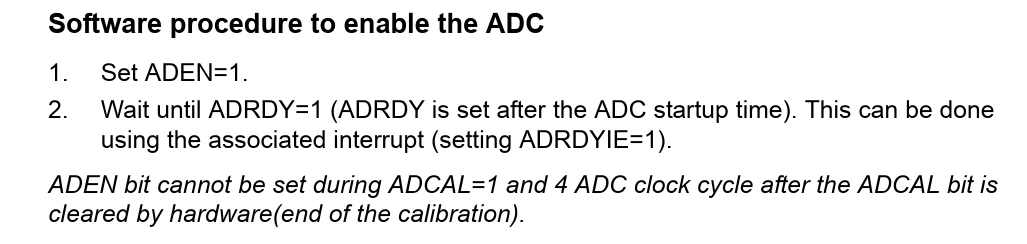

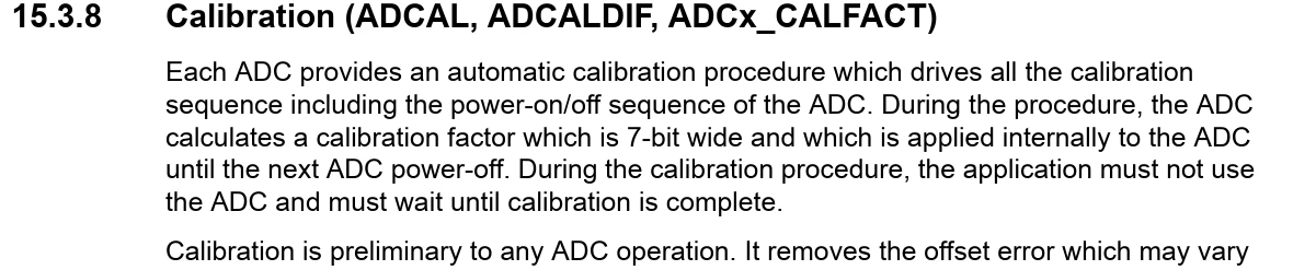

AScha.3
October 30, 2022
did you calibrate ADC ? need it first... see:
0693W00000VORAjQAP.pngso: first calibrate, wait, enable , wait , -> ready. set ADC channel, start ADC.

Hum whenever I need an operation of waiting for the hardware to set those bits it just freezes :\ since the calibration needs to wait until ADC_CR_ADCAL != 0
void Calib(ADC_TypeDef * adc){
	adc->CR &= ~ADC_CR_ADCALDIF;
	adc->CR |= ADC_CR_ADCAL;
	while((adc->CR & ADC_CR_ADCAL) != 0){}
even disabling the ADC freeze at waiting
