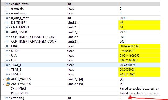

The problem im encountering is the following one:
Everytime the ADC starts, the buffer where all the data comming from the sensors goes is filled with 0. So everytime i try to intiate the program it obiously detects that the values are out of range and therefore i cant initiate the program and the error flag instantly pops up.
Is there anyway i can "wait" for the ADC without introducing any kind of blocking mode in the program?

> I am currently using an STM32 U545, both ADCs (1 & 4) configured to read voltage values comming from different sensors that i have on my pcb. The ADC is configured in DMA mode so i can have this reading process runing in parallel ...
I don't quite understand what do you mean.
Because ADC 1 and 4 are separate peripherals, and (usually) require separate triggers and separate DMA channels. I know of no STM32 MCU that would gather channels frm separate ADCs into one array for you.
Although it might be possible that both could use the same timer as trigger.
I usually configure a TC interrupt event of the DMA, which informs you that an ADC sequence has finished, and all results are transferred.
I think you talk about a debugger view window here.
This is not real-time, mind you.
Marc3Author
March 24, 2025
Yes, ADC1 and ADC4 are separate peripherals therefore, there are two channels of the DMA for both adcs and two buffers on where to put the data incoming from both sensors but both of them are triggered with the same timer for better synchronization.
Would you consider "real time" if in the debbuging window i go step by step in the program?
I meant the usual "realtime" displays in debugger windows. Their output is usually not synchronized with anything, and is can be described as "best effort".
Single-stepping might not reveal all runtime issues as well.
You could use the DMA_TC interrupt(s), as mentioned. I don't know if it can be guaranteed that they always appear in the same sequence in each cycle. If not, you would have to sync both event another way.
When both TC events have occured after an ADC trigger, an evaluation of the ADC results is to be started.
