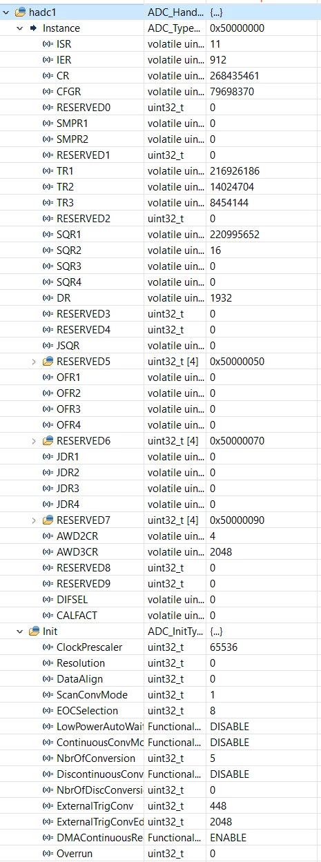

ADC overrun error. Multiple DMA usage.
I am using a NUCLEO F334 development board.
I am using the ADC with the DMA. I developed that feature and tested and everything looked alright. I have been developing some more over that and I see that after startup the values are correct but after a few ms the read values are not correct and in the checked cases, above the expected value.
I have seen that changing totally unrelated parts of code affect this issue happening or not. Changing the compiler optimization also affected whether the issue happens or not.
Browsing around I found an article discussing the usage of the volatile keyword on variables tied to hardware, like the DMA buffer and using the volatile keyword in that buffer made it look like it was the solution as adding or removing the change allowed for repeatable tests where the issue was happening or not, and I moved on. A few unrelated changes later, the issue is back. Do you have any suggestion of what should I check or what is the reason?

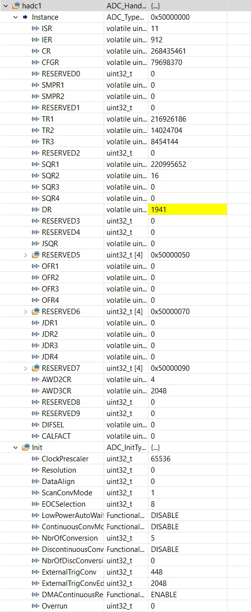

In addition, find attached the a picture with the ADC object before and after crashing.0693W000000WxBRQA0.png0693W000000WxBHQA0.png
What do "correct" and "not correct" mean here? How do you know they are incorrect?
Program behavior changing as a result of optimization generally means there's an issue somewhere. It's possible you're writing to an array out of bounds, or overwriting the stack, or accessing a local variable out of scope. You'll have to use the symptoms to diagnose where the issue might be.
I doubt usage of the "volatile" keyword here fixes the underlying issue.
What do you mean by crashing?
mur
murAuthor
May 6, 2020 9:01 AM UTC
By correct and not correct I mean whether or not the ADC read value matches the voltage. For knowing that I measure the voltage with a scope and do the calculations to know what value should be read by the ADC (*4096/3.3).
By crashing I mean that moment where the ADC stops reading the proper value.

Are you checking the ADC->DR register to determine if the reading is wrong or are you checking the value stored in memory? Your screenshots show the same DR value in both of them, within tolerance.

I'm using the ADCs in Dual regular simulataneous mode and collecting the values with the DMA. Then on ADC EOC interrupt, I'm parsing the values from the DMA and storing them in memory. The values I'm checking are in memory.
ADCs DR do not match the values before nor after crashing. I think that using the ADC in Scan mode, the DR register should keep the value of the last conversion. But that is not happening. :\

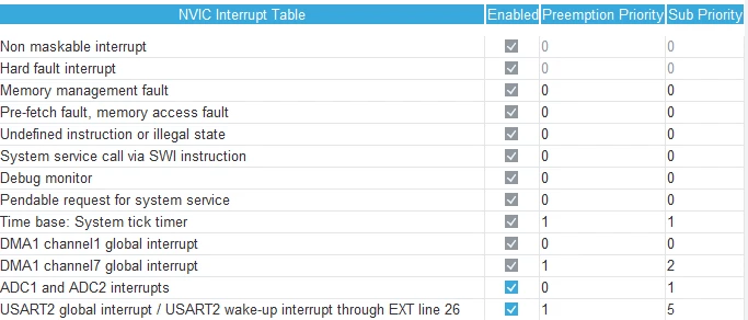

0693W000000X87QQAS.pngI'm sampling at 20kHz with timer trigger. My device is the stm32f334r8 and I don't think I have the fifo feature in the DMA so i will say no. I understand that the overrun is caused by the DMA not being able to service the ADC.
Then the only reason I can think of is that an interrupt with higher priority than the DMA is running and not allowing the DMA requeest to be serviced. Looking at my NVIC (and assuming that the DMA request will have the same priority as the DMA Interrupt, which is some assumption) configuration I dont really know what can the conflicting interrupt be,
In the interrupt for ADC EOC, I set a digital output to '1' on entering the INT and back to '0' at the INT end and analysed the digital output witha logic analyser and the CPU usage time is within threhold (11us) and I can also see that the digital output is at 0 when the error happens (I have a watchpoint at the error variable). What other reasons could there be for the overrun?

DMA doesnt use interrupts to do its thing. At least, that wouldnt be the cause of the overrun. 20kHz is slow, so I doubt the reason is due to the sample rate.
Is it one channel per 20kHz or all of them at that rate?
