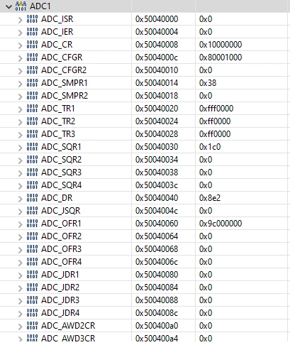

Registers while device is paused, currently a floating pin:
And measured results of the DR register:
Pin grounded: 0x7C0
Pin floating: 0x8E2
Pin 3.324V: 0xFBF

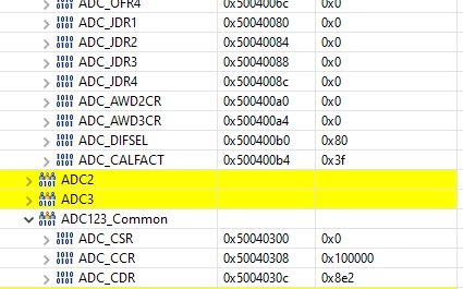

> I'll post a screenshot (or a few) of my register readouts for ADC1 and ADC123_Common in the original post.
OK so you've posted a screenshot, where ADC_SQR1=0x1C0, i.e. one conversion and that's on channel 7; and ADC_DIFSEL=0x80, which means the conversion on channel 7 is differential.
The mcu does not work out of what you've clicked in CubeMX, it works out of the registers' content.

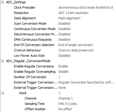

HCLK is set for 80MHz, ADC settings are below:

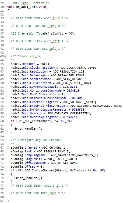

November 29, 2023
The ADC channel could be in differential mode. Are you missing sConfig.SingleDiff = ADC_SINGLE_ENDED? Or other members of sConfig? That part of your code isn't shown.

November 30, 2023
@TDK:
This is single-ended, and configured as such.  I did post a screenshot of the ioc setup, I'll amend my original post with this information.
I'll give it a shot, couldn't hurt.  I *can* tell you I've compared my code to several of the sample projects for ADC, as well as comparing with code written by my boss on a different project, and the code looks correct.
