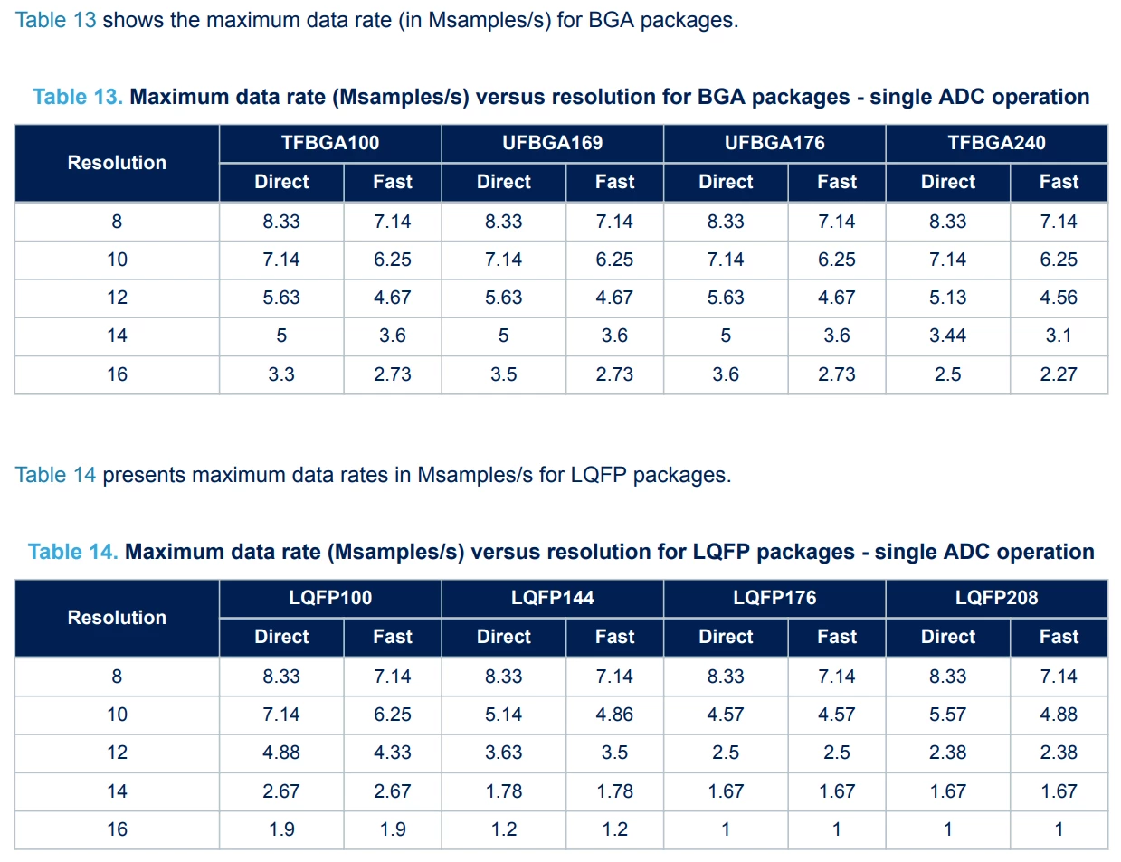

August 17, 2020
> 3.6 Msps is at 16 bit resolution.
You're right. Interestingly, the max rate appears to be package-dependent:
Are you interfacing with registers directly or are you using HAL to accomplish the setup?

August 17, 2020
Interesting tables, thanks!
I bought a Nucleo H745ZI-Q development board to learn about STM32 programming.
In order to flatten the learning curve, I only use the HAL functions...
Also, I use the STM32CubeIDE for programming.
My board seems to be fitted with the LQFP144 package.
So at 4 Msps, 10 bit is the best it can do...
