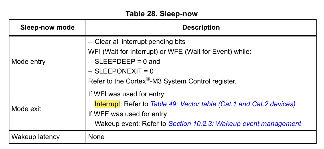

July 25, 2025
An interrupt from the ADC will wake up the chip up from sleep.
