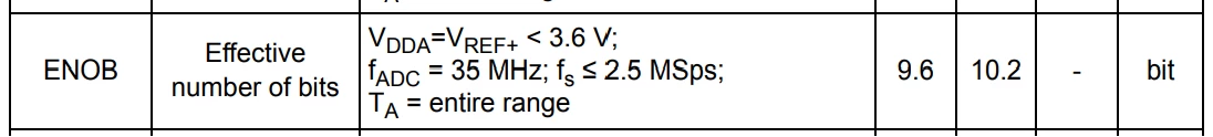

A few counts is within the ENOB values in the datasheet.

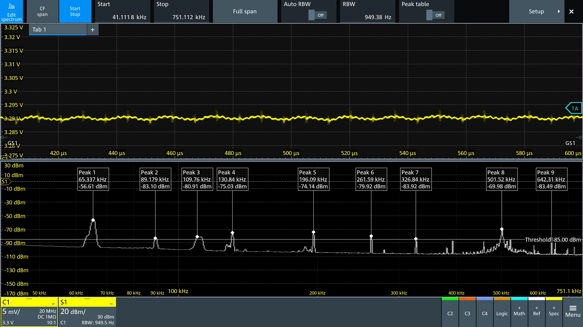

Thanks @ONadr.1 and @TDK for reaching out. At the moment there is no output filter used on the op-amp, only a lagging capacitor placed between non-inverting and inverting inputs of op-amp. The impedance of this signal is very low considering its the output of the op-amp. The digital signals are away from analog circuitry. I have just investigated to see what my VDD/VREF+ are experiencing and this is what I found:
There is a 65.3 kHz ripple which comes from the switching frequency of the converter and its harmonics. However, there is a noticeable superimposed, relatively high amplitude noise at 500 kHz which is due to an external bias supply (flyback) switching.
I might have to filter this out more, provided that the ripple is easily higher than 1 LSB (800 µV) of ADC. I am even considering of using a PI filter from VDD to VREF+, what are your thoughts on that? I could try filtering out at least higher frequencies with this method?
Note: the signal spectrum is captured with 'hold max' method and limited to 20 MHz.

I would try to put an LC filter between VDD--VDDA. If the MCU package has the possibility to use an external Vref, then one more RC filter between VDDA--Vref (VDDA as reference) or capacitors (1uF+22nF ceramic) between Vref and analog groun (iternal ref as reference).

@ONadr.1 The problem with this chip is that it does not have a dedicated analog power supply pins. Sure, I will try RC and potentially LC from VDD to VREF+.
