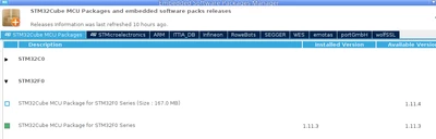

Did you try to up- or down- grade the software pack:
(in IDE, in edit ioc -> CubeMX-> manage software packs ...) then you see this;
JS8Author
December 21, 2023
I removed the most recent install and installed the previous software pack. Didn't work, sadly.
