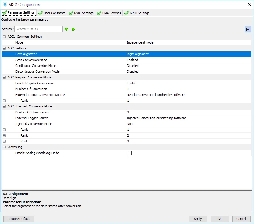

Hello everyone
i have a question, i am using 3 Ranks ADC injected mode for reading potential resistors..
the problem is when ever i change one value it affects the other channel reading.
example
channel 1
 reading is 1.3v
channel 2
 reading is 1.5v
channel 3 reading is 1.6v
changing only resistor value on channel 1 to 2.9v makes the following:
channel 1
 reading is 2.9v
channel 2
 reading is 1.7v
channel 3 reading is 1.7v
why when i change one value the others are affected !! or the second one affecting the third !

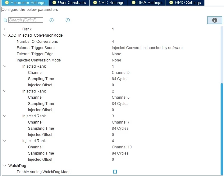

IMaji
December 18, 2018
Same problem.
Who knows why and how to fix it?

Perhaps use a sample time setting commensurate with your ability to change the charge level on the sampling capacitor?
IMaji
December 19, 2018
Here is the mine configuration. I changed Sample time value but no changes.0690X000006Cs7TQAS.jpg
