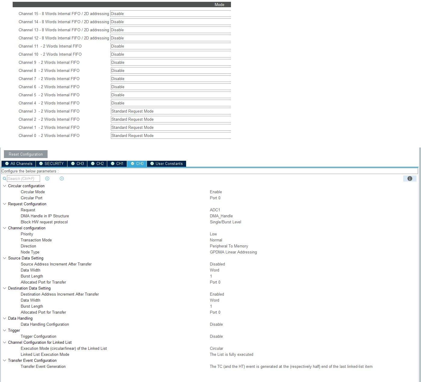

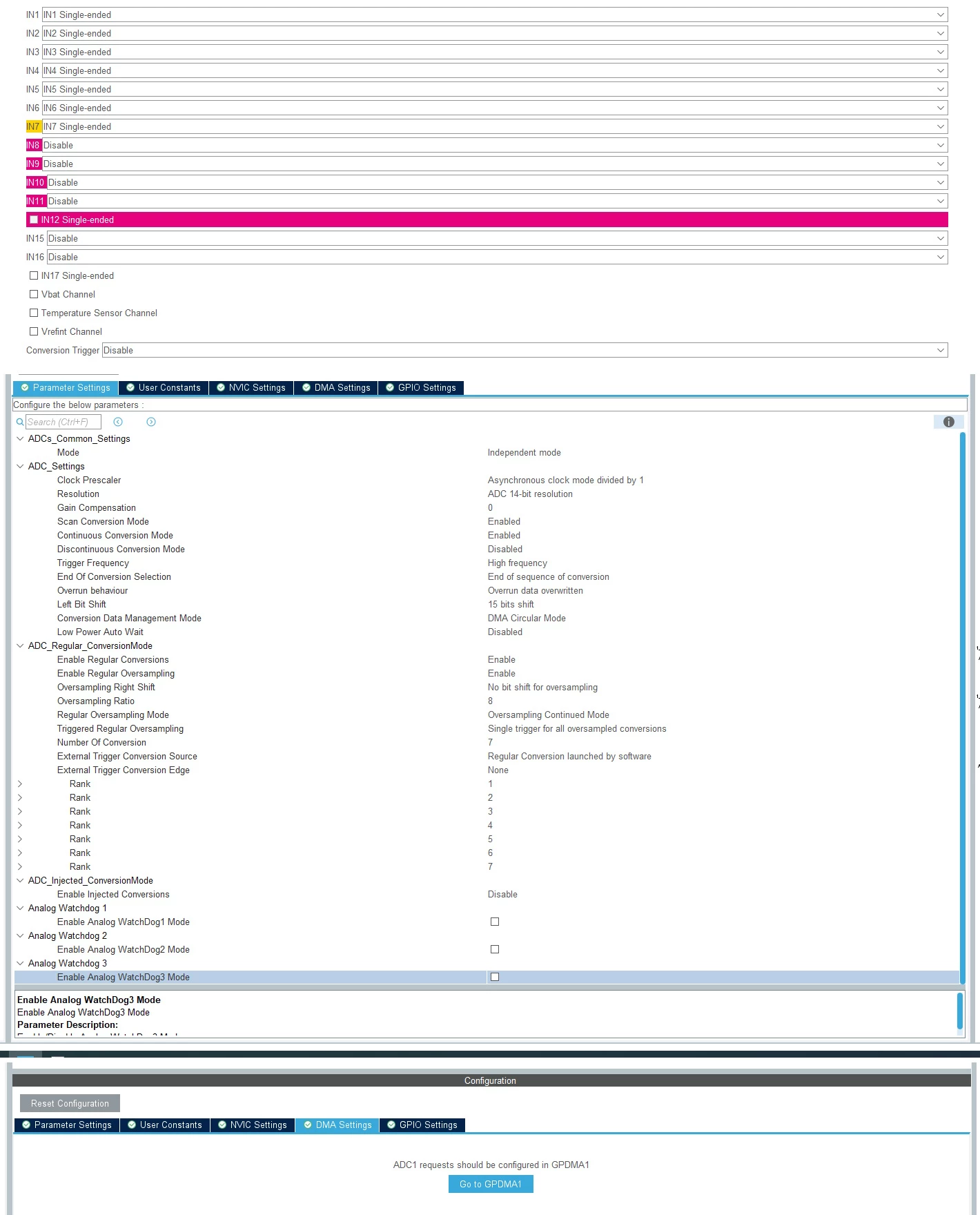

We have a STM32U575xx chip, where I want to read a bunch of voltages continuously.
These voltages don't need to be measured at a particularly high rate, nor does the timing need to be strict. So it seemed efficient to run the ADC continuously with DMA. We expect that somewhere in memory there are constantly updating ADC readouts, and we can read these values when we want to, without any blocking calls. Any unused values can just be overwritten again.
However, this doesn't work entirely: we can do a non-blocking ADC read with DMA, but it seems to be only a single read, while I was expected a continuous readout because the ADC is in independent mode.
We start the ADC/DMA on init:
 HAL_ADCEx_Calibration_Start(&hadc1, ADC_CALIB_OFFSET_LINEARITY, ADC_SINGLE_ENDED);
 HAL_ADC_Start_DMA(&hadc1, m_adc1Values, Adc1NbrChannels);
Why does this ADC stop? Am I missing a setting, or does 'continuous' and 'independent' not mean what I expect it to?
It concerns ADC1, channels 1 to 7. We set it up with GPDMA1, channel 0. The complete CubeMX configuration is below.

Jan 13, 2025 7:43 AM UTC
Really? The pictures are in high resolution and I can read them fine. You'd have to open the file in the browser and click the zoom button or download the bitmaps first and use a local viewer. Direct links:
https://community.st.com/t5/stm32-mcus-products/adc-in-continuous-mode-with-dma-stops-instead-of-running/m-p/760651?attachment-id=29553
https://community.st.com/t5/stm32-mcus-products/adc-in-continuous-mode-with-dma-stops-instead-of-running/m-p/760651?attachment-id=29554

@gbm wrote:
It will probably be useful to use continuous ADC conversion with DMA in circular mode. STM32 doesn't like it's ADC to be stopped for more than 0.5..1 ms.
DMA is already in circular mode, visible in the screenshot.

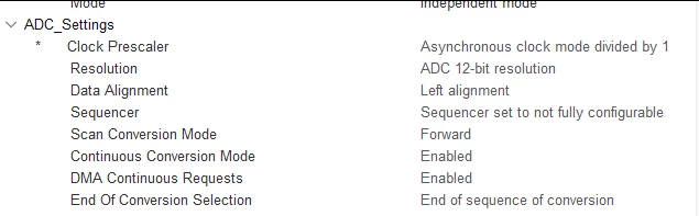

Robert_149494AuthorBest answer
Jan 27, 2025 9:17 AM UTC
I think I've found the solution (but it's hard to adequately test currently).
I found two settings that were incorrect:
"DMA continuous conversions" should be Enabled (don't know how I missed that) and "End of Conversion Selection" should be "End of sequence of conversion".
With those settings I managed to get a continuously ADC, though I saw one of the channels produce only zeros. But that might have been an unrelated issue.
