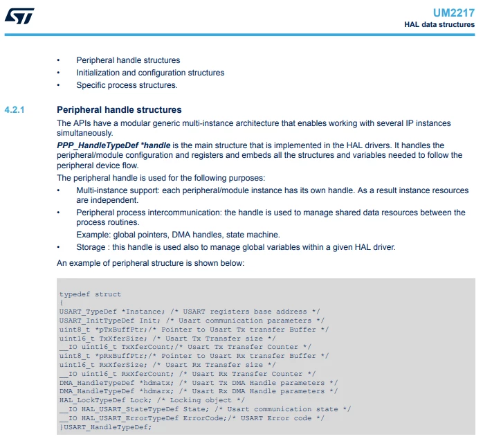

@StanCosgrove wrote:
 what's the meaning of pointer *h in the function argument
That's just standard C: h is a pointer to an object of type ADC_HandleTypeDef - an ADC Handle.
See the HAL User Manual for details.
You can also select the type name, and use 'Go to definition' - there will be documentation alongside the definition.

Andrew Neil
February 26, 2024
 pointer *h
Note that the pointer is just h;
*h is dereferencing the pointer; ie, accessing the thing that the pointer points to.
