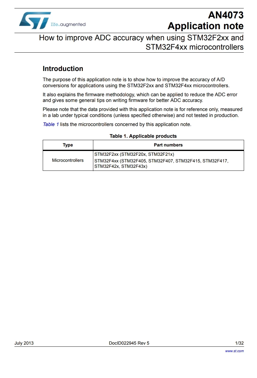

Hi STTwo-32,
The picture you posted from AN4073 mentions only these STM32F4 MCUs as applicable:
STM32F405, STM32F407, STM32F415, STM32F417,STM32F42x, STM32F43x.
AN4073 is not applicable to STM32F446 since neither STM32F446 nor STM32F44x is in the list. Nor is the list open ended ... e.g. ending with ellipses, something like "STM32F43x, ...)".

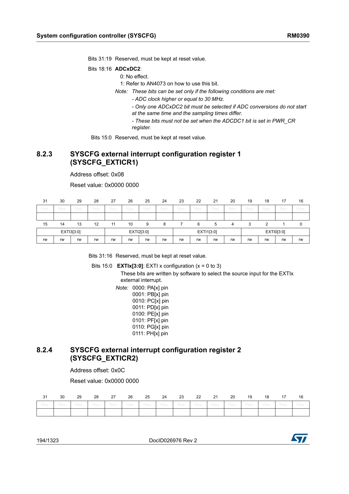

But here is a picture form STM32F446 reference, which points to AN4073:
The description of ADCxDC2 refers to AN4073 like this:
"1. Refer to AN4073 on how to use this bit."
Errata for STM32F446xC/xE refers AN4073 is a similar way.
It just looks like the list of applicable MCU in AN4073 is not complete (i.e. it is missing STM32F446).
That only looks like a minor documentation bug. I'm more interested in a better description how ADCxDC2 works and why it seems to be working despite my ADC frequency being only 22.5 MHz.

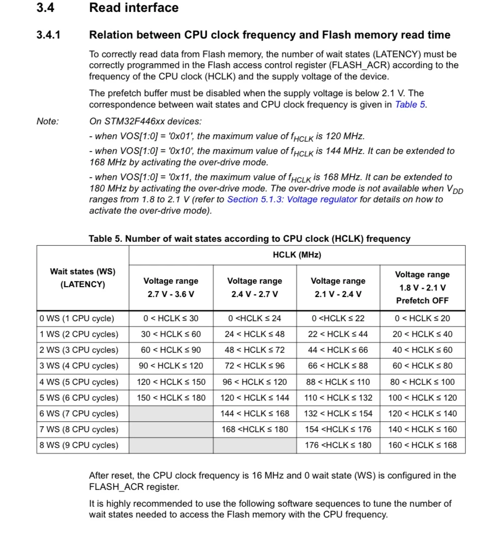

If I remember well ,  Indeed all STM32F4 MCUs designed after the STM32F427/429  - more than 10 years ago , have the same ADC bits to improve the accuracy. This Option 2 is a bit dangerous in case of ADC Frequency is less than 30MHz as such value is not by chance but is the Highest value for Flash Wait state  0 as below and indeed depends on Voltage range :
To activate this Option , we should ensure that our customers software is protected and so it consist on disabling ( gating) by hardware any access to the flash fetching during the sampling phase and ensure the timing window will fit correctly . If not CPU can access the Flash while the clock is stopped to flash and so make a hard fault or something like .

6) CPU core can tolerate only as much additional latency caused by ADCxDC2 as defined in LATENCY bits of FLASH_ACR.
The problem is that point 6 does not seem to be true. My STM32F446 runs at 180 MHz. Voltage is 3.3V. LATENCY is set to 5.  But it seems to work just fine with ADC frequency 22.5 MHz and ADCxDC2 on.
I guess I could change LATENCY to 7 and then it should work OK (180/(7+1) = 22.5 MHz). It would be quicker than lowering CPU frequency to 144 to achieve ADC frequency of 36 MHz.
