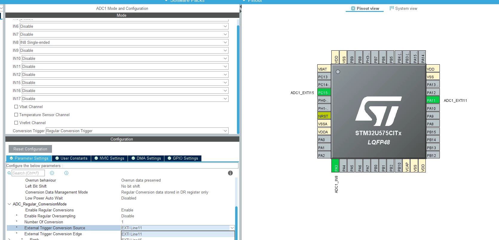

MCU: STM32U575CIT
My goal is to use ADC1 and trigger it from external source.
In CubeMX I select one regular channel and set Conversion trigger to Regular Conversion trigger.
What happens next is BOTH ADC_EXTI15 and ADC_EXTI11 are activated, and I can choose one of them in external trigger source.
My problem: I don't want to use both EXTI pins. Any way I can activate only one of them(for example EXTI15) and left EXTI11 in reset state?

Hello  @Next,
This is indeed a bug in our CubeMX generator. I report it internally to fix it.
You can de-init the GPIO you are not interested in is the source code.

Hello  @Next,
