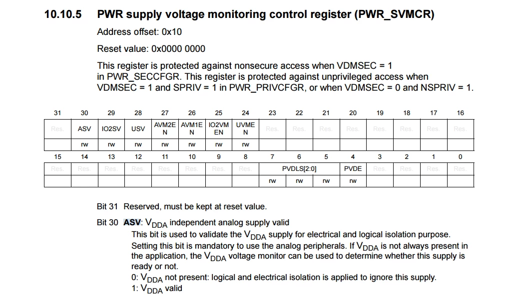

I’ve been working on a project for a while and initially generated the code only once at the beginning to set up the hardware configuration. Recently, I updated STM32CubeIDE from version 1.14.1 to 1.15.0. After updating, I regenerated the code without making any additional configurations, yet I noticed that ADC1 and ADC2 stopped reading data. I've double-checked the configuration and the clock settings, and they appear identical to what I had previously. I also compared the HAL files, and they seem fine. All other peripherals like SPI, UART, and I2C are functioning correctly, except for the ADC. Am I missing something here?
Best answer by Anassoumi
I've identified the root cause of my ADC issue related to FreeRTOS. It turns out that the ASV bit in the PWR->SVMCR register was never enabled during the initialization phase. This bit is essential for the proper operation of analog peripherals ... I suggest that this step be included in the HAL initialization code in future updates .

Anassoumi
AnassoumiAuthor
April 18, 2024
Sure ,Project Blue.ioc is the original one i'm working with before the ADC stopped responding , Project Blue2.ioc is after the generated code , also i noticed the DRDY register of adc is never enabled for some reason , i've tried to create a new project with the updated cube ide version and worked just fine but once i enabled freertos , the adc stopped responding

Can someone who has access to an stm32u5 do a simple test and confirm that adc works with freertos on the latest version of cube ide ?
Anassoumi
AnassoumiAuthorBest answer
April 22, 2024
April 22, 2024
Hello @Anassoumi
I confirm the issue.
The "HAL_PWREx_EnableVddA()" must be invoked in "stm32u5xx_hal_msp.c" when activating ADCx.
This issue is internally tracked with the ID: 176661, and a fix is planned for the upcoming version.
(PS: ID: 176661 is an internal tracking number and is not accessible or usable by customers)
