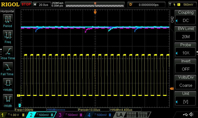

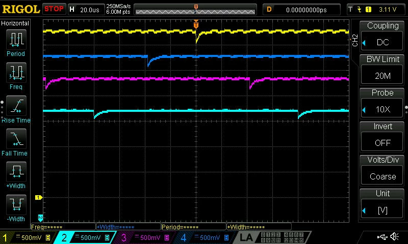

I can see that the S/H is working as shown in the waveform below.
The circuit is similar to HRTIM cookbook section 7.1 Debugging ADC operation.
Below is the HTRIM output

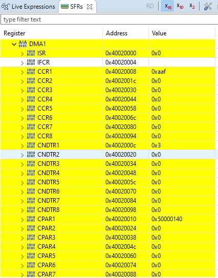

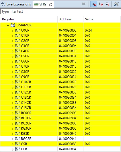

victagayun
Senior III
May 24, 2020
So far this what I get from DMA1 and DMAMUX, reading RM now...
after
 if (HAL_ADC_Start_DMA(&hadc2, adc_four_ch, 4) != HAL_OK)
	 HAL_GPIO_WritePin(GPIOA, GPIO_PIN_5, SET);
