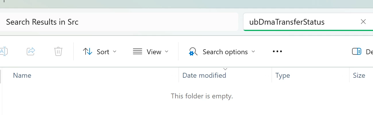

HAL_ADC_Start isn't called anywhere within the files you attached. Not in main(), not in the default task, not in any of the interrupt handlers in *_it.c.
Likewise, I don't see ubDmaTransferStatus appearing anywhere in a text file search of the files.
Sure you attached the relevant files? Am I missing it?
Senior
Jul 3, 2025 3:06 AM UTC
My apologies, I zipped up the wrong project. Please see the new attachment.
