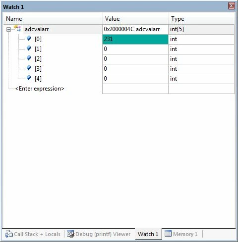

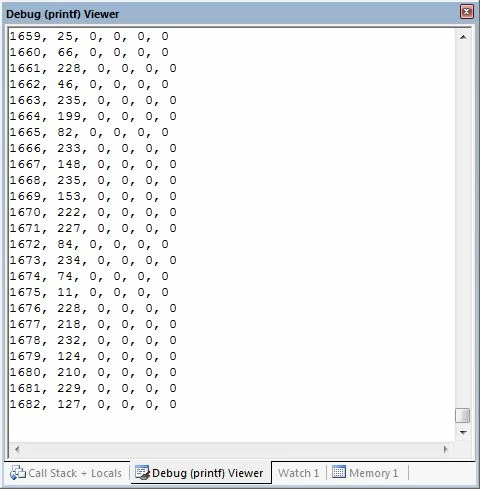

The problem now is my array (uint16_t adcvalarr[5])  only got the 1st index filled with value. Shown below is the result of transmitted data from Watch window and printf debug window.
Watch Window:
Debug printf viewer (from left to right: iteration number, array[0], array[1], array[2], array[3], array[4])
I have also tried using potentiometer to alter ADC values of each channel but none of it seems to change the value in the array either. Is my ADC fried up or is it just something wrong with my code?

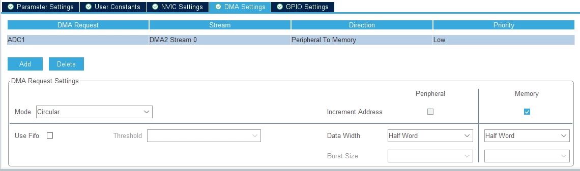

First of all, make sure your DMA is configured as circular mode and memory address is incremented.
Secondly, it seems your ADC interrupt is triggered at the end of each single conversion. That means, you raised the flag adc_conv_complete_flag after the first conversion.

Sorry i forgot to mention that i already configured circular mode and increment memory address, here i provide a screenshot in case I'm not doing it right. I used Half Word length because i use 12bit ADC mode.
I also have my ADCs Global Interrupt set to Enabled, although it doesn't do much when I change the ADC Global Interrupt setting.

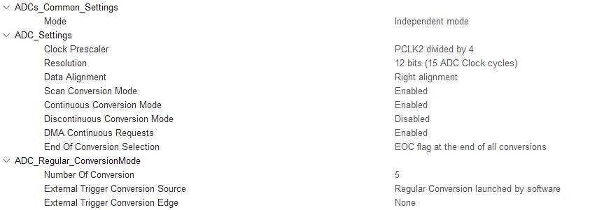

Here are my ADC Parameter settings
Anyway, i tried setting the ADC's EOC as you suggested but the result remains the same...I also tried changing the code so the array get transmitted regardless of the adc_conv_complete_flag  condition, to no success either.
