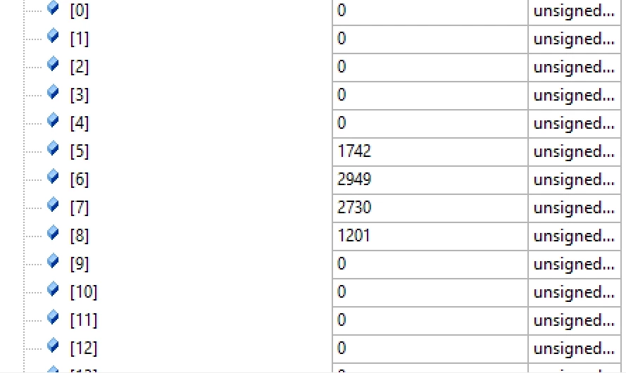

It seems TIMER2 doesn't trigger the ADC using a Trigger update. I switched to Timer 1 and that seemed to solve my issue. However, I'm now facing another issue. The buffer isn't filled and some samples are missing0690X0000088ScQQAU.png
WOuld it be better to open another thread?

ConfusedContrarian
ConfusedContrarianAuthorBest answer
Mar 21, 2019 2:10 PM UTC
S.Ma
Principal
Mar 21, 2019 2:58 PM UTC
To debug, output timer trigger to a gpio and connect it to the adc trigger input pin so you can pinpoint if the issue is on timer or adc+dma side.
