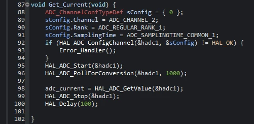

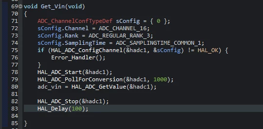

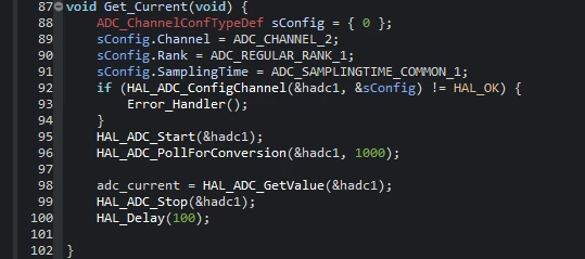

ADC different channel, same value
I am just wondering how it is possible that 3 adc gave me the very same value, if I change the channel and their rank are different.
Thanks for all.
TDKBest answer
Mar 20, 2025 12:59 PM UTC
When converting a single channel in fully configurable mode, rank 1 is the only channel converted.
Two of your three pictures are the same. The other one configures rank 3 which isn't converted.
