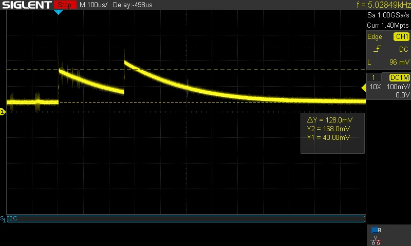

I took the code from https://community.st.com/t5/stm32-mcus-products/adc-in-stm32f446re/m-p/613434/highlight/true#M228331 and modified it so that it performs conversion infinitely. On a 'F407 Disco, this results on a cca 0.6V on PA1 (which is not connected to any other circuitry on the 'F407 Disco, just the pinheader). It's a "steady" 0.6V, with no visible spikes from sampling, so it could be assumed, that that's the voltage to which the sampling capacitor is charged during conversion, dumped to the parasitics of the pin during the repeated conversion.
Then I modified the code further so that it performs one conversion, waits cca 250us then performs second conversion and then stops. The resulting waveform is here:
The "stable state non-conversion" DC offset is cca 40mV, that's given by the leakages. The charge dumped from the sampling capacitor to the parasitic capacitance (pin and tracks and the probe and scope input) increases its voltage by around 130mV which is around 1/5 of what we assume is on the sampling capacitor at the end of conversion (and we assume it won't leak significantly between end of conversion and start of next conversion's sampling), so if the sampling capacitor is 6pF, the parasitics are around 30pF (the pin's parasitics is given as 5pF, scope's input is spec'd at 18pF probe is 1:10 and its input is spec'd at 14pF, so that's together with some track etc. parasitics is around correct). This discharges to the leakage with tau of cca 200us, so the leakage is cca 6MOhm; but there's 10MOhm of scope+probe, so the pin's true leakage is at around 10MOhm too, or around 0.3uA at 3V, which again sounds about right.
