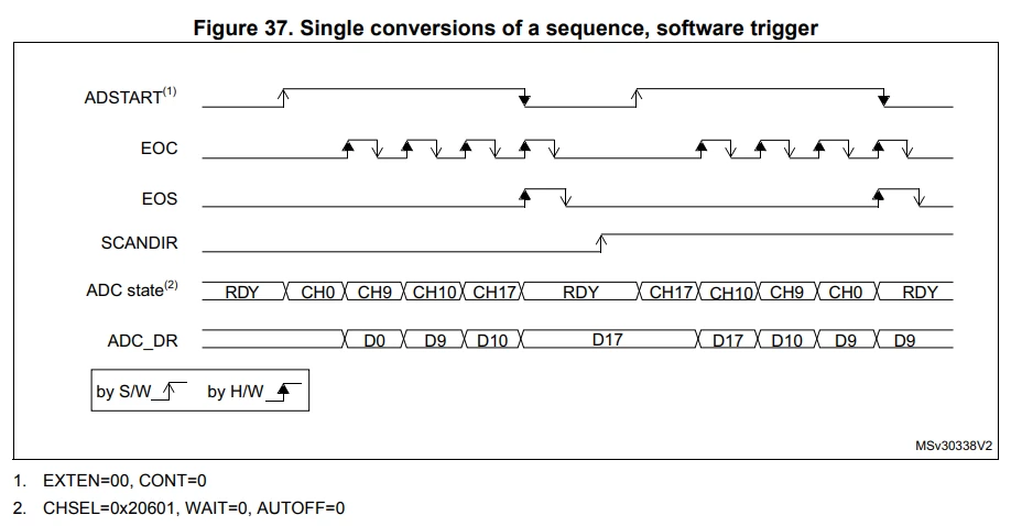

Spider
SpiderAuthor
September 23, 2019
In this picture *not* continuous mode
waclawek.jan
September 23, 2019
Not CONTinuous is not DISContinuous.

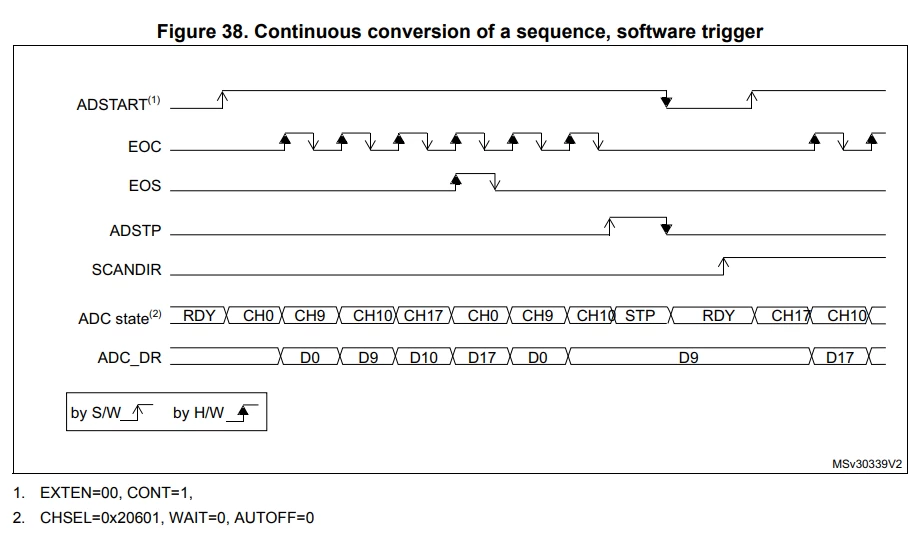

The first is switched on by setting ADC_CFGR1.CONT bit, the second by ADC_CFGR1.DISCEN
This may be confusing, but there are in fact three "autorun" modes: normal, when none of these bits is set. when all conversions of a sequence are carried on automatically, stopping after the sequence, this is what you are after. Then you have Continuous, when after a completed sequence a new sequence is started automatically, there is no stop. Then you have Discontinuous, where there is a stop after each conversion in the sequence.
