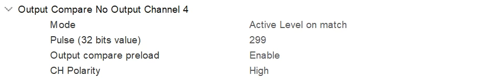

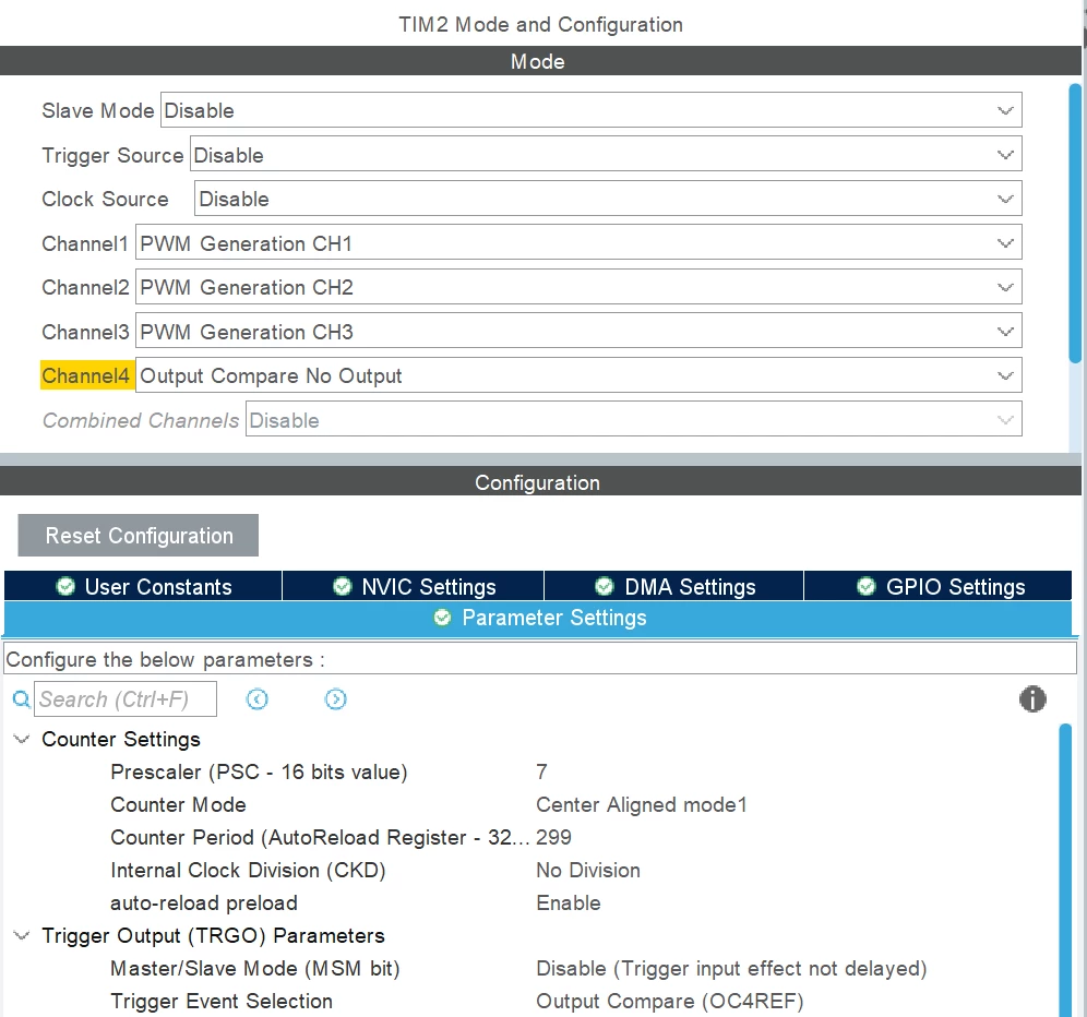

The microcontroller I am using is the STM32F411 series, and I am using the first 3 channels of Timer 2 for PWM. The 4th channel is set to "Output compare no output", and I also set the timer trigger output event selection to Output compare (OC4REF). I set the pulse of channel 4 to the TOP value of the timer so it triggers when the counter counts to the TOP (midpoint of PWM).

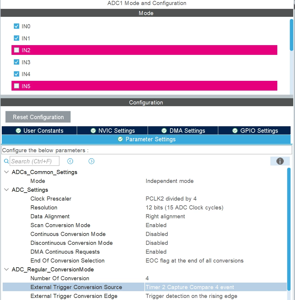

For the ADC, i am trying to sample 4 inputs (2 phases for 2 motors) and shift the data into a buffer using DMA. I enabled scan conversion mode as well as DMA continuous requests, and set the trigger source to Timer 2 capture compare 4 event, triggered on the rising edge. The ADC global interrupt is also enabled.

Read out and check/post content of TIM and ADC registers.
This would probably work, if you set TIM2_TRGO as ADC trigger, rather than TIM2_CH4.
TIM2_CH4 selection in ADC should also work, but ST is sloppy in explaining the details, and you probably need to enable the TIM2_CH4 output by setting TIM2_CCER.CC4E (I dont' Cube/HAL/MX, probably something like setting it other than "no output"), although you don't need to assign any pin to it - see this and the linked discussion there.
