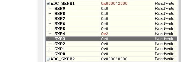

at the moment i try to verify the conversion time of the ADC that is described in the datasheet.
I measure one channel in regular conversion mode without interrupt.
To calculate the conversion time i used the equation in the datasheet.
Tconversion = tsampletime + ConversionTime
The resolution is fixed with 14bit -> 17 ADC cycles.
ADC clk = 3682540Hz.
I toggle a pin after starting the ADC and i toggle the pin again when EOS flag bit is set:
GPIOA_NS->BSRR |= GPIO_BSRR_BS0;
while((ADC1->ISR & ADC_ISR_EOC) != (ADC_ISR_EOC))
GPIOA_NS->BSRR |= GPIO_BSRR_BR0;
I measured the Conversion time with the ocilloscope.
Here are the results ( at the left hand side the measured conversion time and at the right side the calculated):
There is a delay of 6us because of the pin toggling that i have also taken into account for the measurement results!.
TSmpl [cycles]Tsar [cycles]Tconv + PIN Toggle measurement [us]Tconv + PIN Toggle Theory [us]
51711.911.9
61711.912.2
121711.913.8
201716.316
361720.620.4
681729.329.1
39117116116.8
81417233231.6
My question is: Why stays the conversion time the same for the first 3 sampling time configurations?

just (you verified most timings perfectly) , did you verify whats in SMPx[2:0]: (Channel x sampling time selection) really is ?

i already checked the respective SMP register. Here i set the sample time to 12 ADC Cycles.
The register is set like expected.
Below are the ADC1 registers after ADC conversion start and after end of conversion (EOC).
