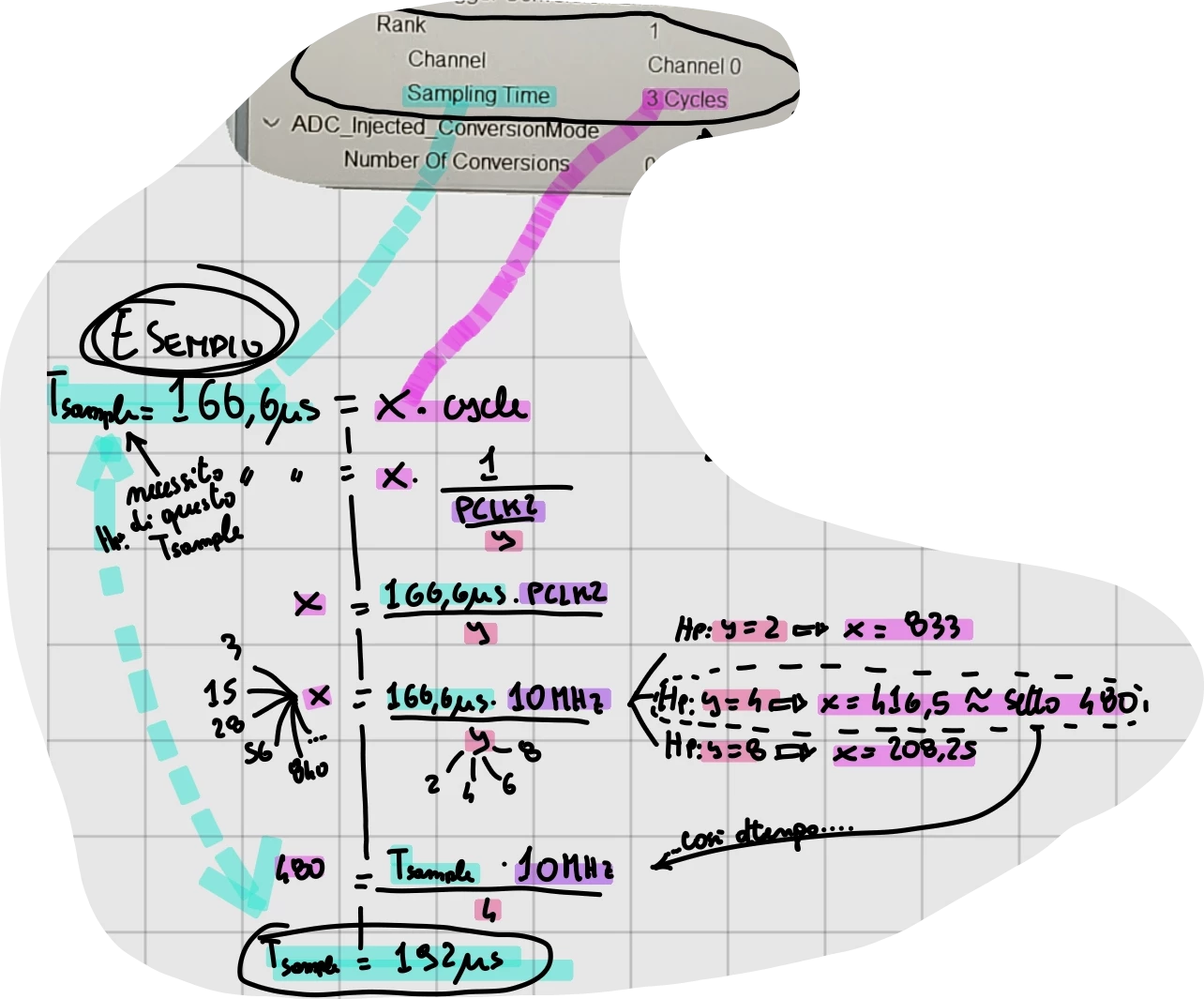

Suppose I need to sample a signal and I need a Tsample = 166.6 us
I need to tell the ADC to sample with that Tsample, however, I need to convert it to cycles:
With some approximation I find 480 cycles --> Tsample = 192us (a little different from 166us but it's okay)

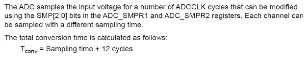

EDIT: I have to take into account that the datasheet says that Tconv = Tsample + 12 cycles
          so actually ADC takes Tconv = 480 + 12 cycles = 492 cycles = 196.8us .. not 192us
1a) Are these calculations correct?
How long does it take the ADC to convert each sample?
It depends on the resolution, right?
If I use 12 bits, the ADC will need 12 cycles + 3 cycles = 15 cycles ... which converted to seconds are:
15 * 1 cycle duration = 15 * 1/(PCLK/Perscaler) = 15 * 1/(10MHz/4) = 5us.
2a) Are these calculations correct?
2b) Does this mean that every Tsample = 192us the ADC read a sample and takes 5us to convert it?

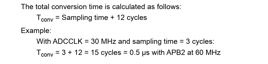

steht wunderbar im rm :
so with this example settings adc converts in 0,5us .

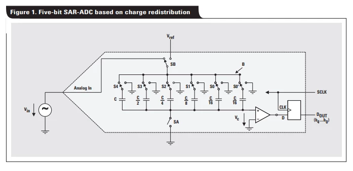

this kind of adc are capacitive SAR converters , see:
https://www.analog.com/en/technical-articles/successive-approximation-registers-sar-and-flash-adcs.html
https://www.ti.com.cn/cn/lit/an/slyt176/slyt176.pdf
so: sampling time is first part of conversion, where the input cap C is connected with the input pin and charges to the voltage at this pin. then comes the fixed 12 cycles ...together this is the total conversion time. ok ?

So I suppose my calculation 1a) is correct ... I gave an example just so I wouldn't make a mistake.
