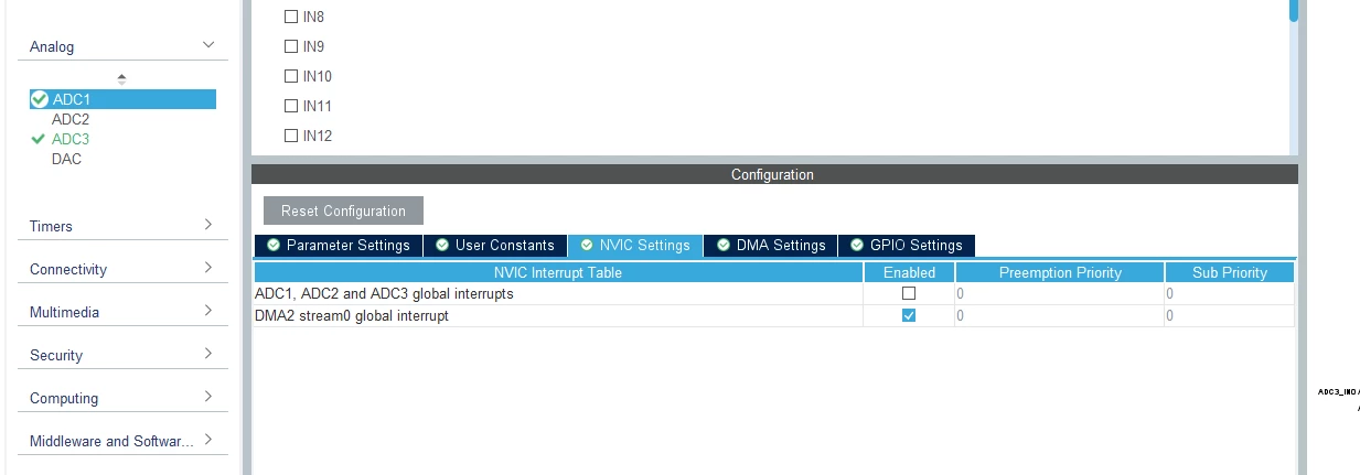

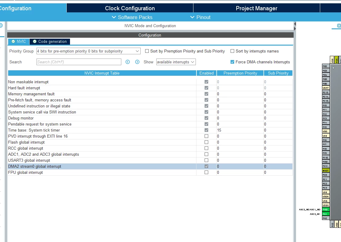

Senior III
April 20, 2023
If you use CubeMx you can uncheck options "Force DMA channels Interrupts":
Dudo
Senior III
April 20, 2023
Also you can uncheck in ADCx settings but first you must uncheck as above "Force DMA channels Interrupts":
Dudo

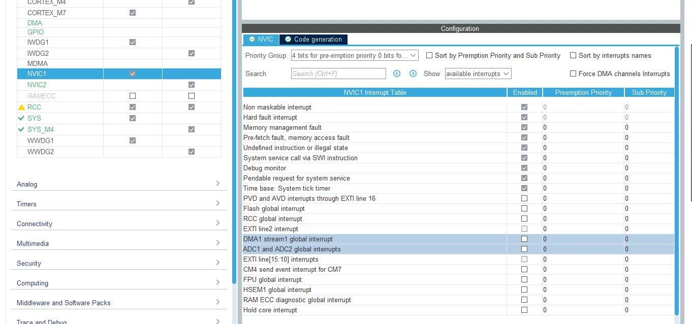

SA V.1
SA V.1Author
April 20, 2023
Thank you for" your HELP" i made the changes above and checked no output . I thought we Can't get WIthout the DMA interrupt . Can you discuss with your collegue or those who have highly known about this topic and Reconfirm about this please ??
Senior III
April 20, 2023
I don't understand why you mix two topics: interrupts dma and receiving data from ADC. What's your target ? Receiving data or disabling interrupts from dma?
Dudo

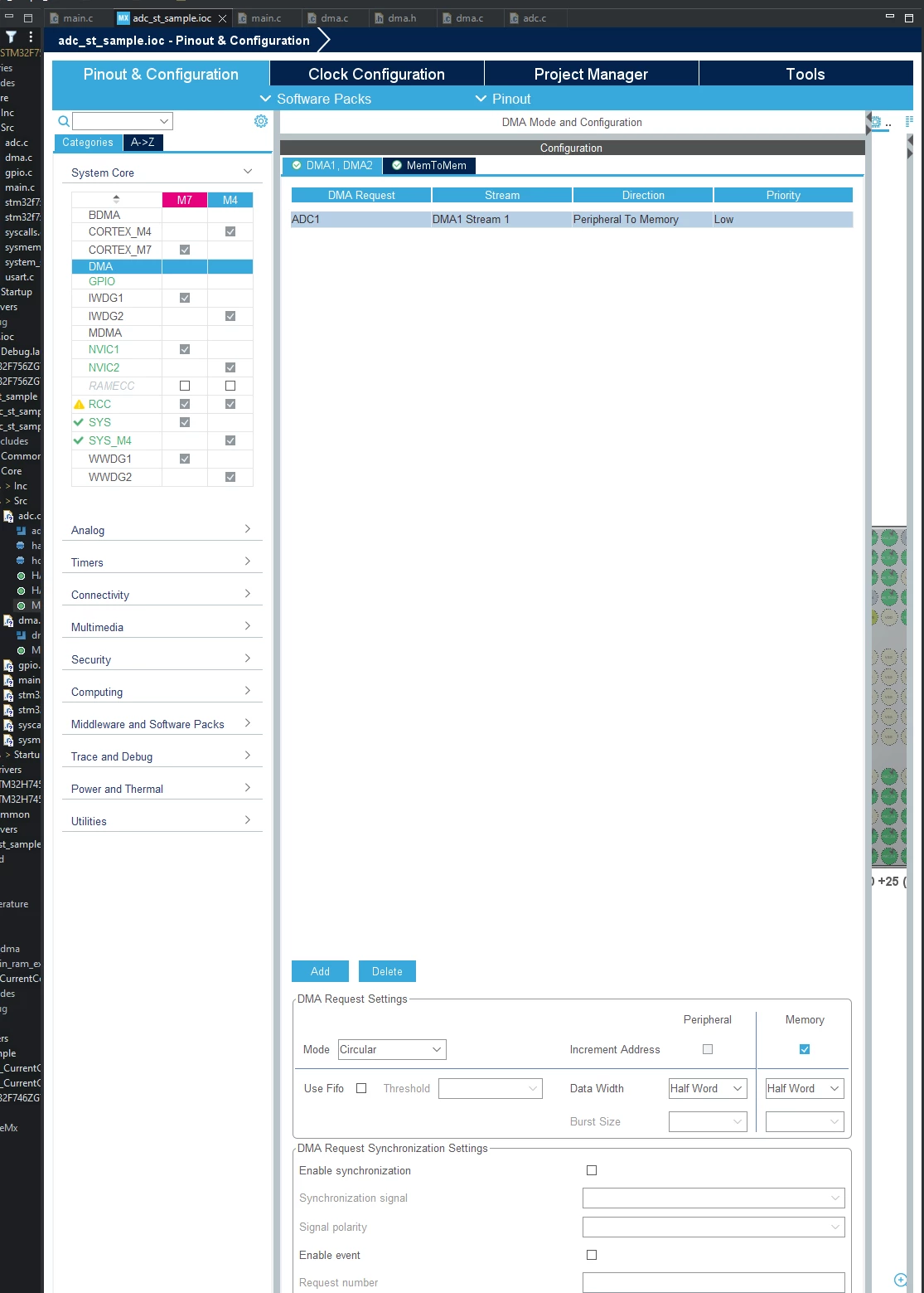

Senior III
April 20, 2023
I also don't see init DMA in your code:

Ok, so achieved your target with DMA. Interrupts You can still disable in the nvic label if you want:

You will learn a lot when reading the reference manual and the registers, then looking into the HAL functions to see what's going on.
So you might check what's going on in:
HAL_ADC_Start_DMA() shows you that DMA interrupts are enabled.
And the callback functions ADC_DMAHalfConvCplt() and ADC_DMAConvCplt() are set for DMA interrupt callbacks. Which do some housekeeping and then call the HAL ADC callbacks... (which shows us that this might not be the fastest solution...)
HAL_DMA_IRQHandler() which is called at each DMA interrupt.
It's mostly error handling, but also resetting (half-) transfer complete flags, and calling the (half-) transfer complete callback functions.
So all that might give you the hint that you need the DMA interrupts for that ADC DMA stream.
What you do in the HAL ADC callbacks is your thing.
Maybe set a flag to show that new data is available?
Anyway, when using ADC with DMA you do NOT need that ADC_get_value_whatever function, DMA is writing the ADC values directly into the specified buffer at DMA start.
Stop relying on CubeMX and HAL stuff alone. Start learning and thinking!
