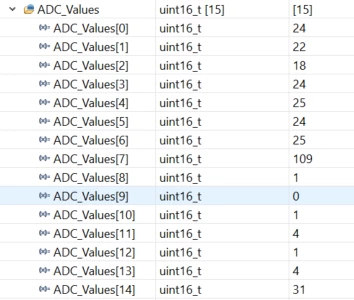

Using F401 ADC continuous conversion and DMA for multiple channels.
I have pins A0-7, B1, PC0-5 running conversions. For consecutive pins in a group (A0-7) (C0-5), the final pin in use always has a different offset error to the rest. Note this actually means the final /used/ pin in the group, e.g. If all 8 pins in group A are used, pinA7 has a different offset error to the rest. If only the first three 3 are used pinA2 has a different offset error to the rest. If the first 4 pins are used pinA2 no longer has the additional offset error but this is passed on to pinA3.
These results are conversions from all pins being used. The ADC inputs are grounded with pull down resistors in all cases. The different sets of values (0-4 vs18- 25) represent different input impedances from input circuits. The ADC is 12 bits so the offset errors aren't particularly problematic, the issue for me is what could be causing the last value to have a different offset error?
I've measured the pins with my oscilloscope, the B and C group are at 0 volts and the A group are approximately 20mv. I think the issue is in firmware but it's mysterious to me.

Best answer by TonyFauci
The list of ADC Channels used didn't correspond to the pins specified. Simple mistake.

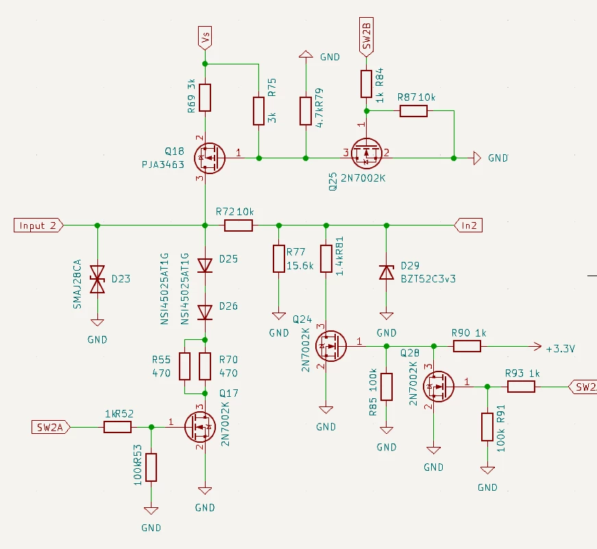

25 is a lot of counts for a grounded input. Can you show a schematic? Clearly looks like PA pins are connected differently than PB. Might help guide the answer.
TonyFauciAuthor
November 27, 2023
It's a multifunction input. I've removed the pull up to make sure the 20mv on the input isn't due to it. I think it's due to the resistors to ground and the leakage current of the pins, 1-3uA and 10k 1.4k 15.6k to ground.
