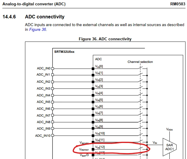

I am just trying to run adc in discontonous mode to measure some voltate from two resistor divider connected on channel 6 (PA1) and channel 7 (PA2) and also Vref from internal channel 12 as per datasheet. see below screenshot from DS14581- Rev2

I have tested that when I choose below configuration for channels . I get the desired results.
ADC1->CHSELR=ADC_CHSELR_CHSEL5|ADC_CHSELR_CHSEL6|ADC_CHSELR_CHSEL11;
So that clearly means that  ADC channel 5 is connected to PA1, ADC channel 6 is connected to PA2 and VREFINT is ADC channel 11 in contrast to what is mentioned in the reference manual RM0503 Rev2. and the datasheet of the product.
Please confirm.

Hello @KSB ,
First, I apologize for my late reply.
Thank you for bringing this issue to our attention.
I confirm this is a documentation issue. In the DS14581- Rev2, ADC channels numbering starts by mistake from ADC_IN1 instead of ADC_IN0.
I reported this typo internally
