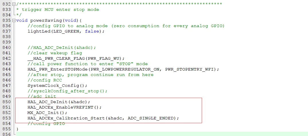

   I'm using STM32L071RBT6 MCU, encounter a strange issue. when MCU power on, using ADC channel 0 to monitor external battery voltage, the result is OK. but once system waked up from STOP mode, ADC converter behavior is abnormal, the sampling value random varied from 0 ~ 2000. following is my STOP method, can give me some hint?

* trigger MCU enter stop mode
void powerSaving(void){
        //config GPIO to analog mode (zero consumption for every analog GPIO)
        lightLed(LED_GREEN, false);
        //HAL_ADC_DeInit(&hadc);
        //clear wakeup flag
        __HAL_PWR_CLEAR_FLAG(PWR_FLAG_WU);
        //call power function to enter ''STOP'' mode
        HAL_PWR_EnterSTOPMode(PWR_LOWPOWERREGULATOR_ON, PWR_STOPENTRY_WFI);
        //after stop, program continue run from here
        //config RCC
        SystemClock_Config();
        //sysclkConfig_after_stop();
        //adc init
        MX_ADC_Init();
        HAL_ADCEx_Calibration_Start(&hadc, ADC_SINGLE_ENDED);
        //config GPIO

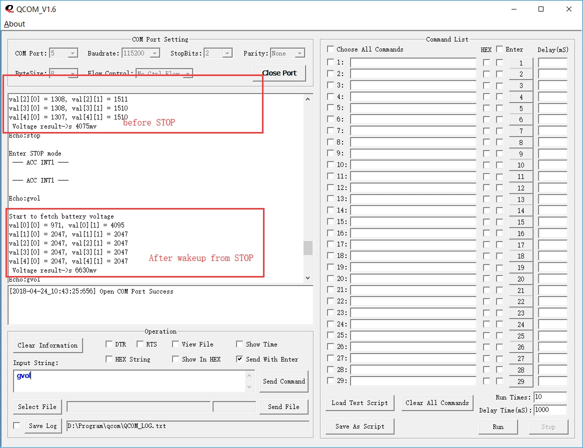

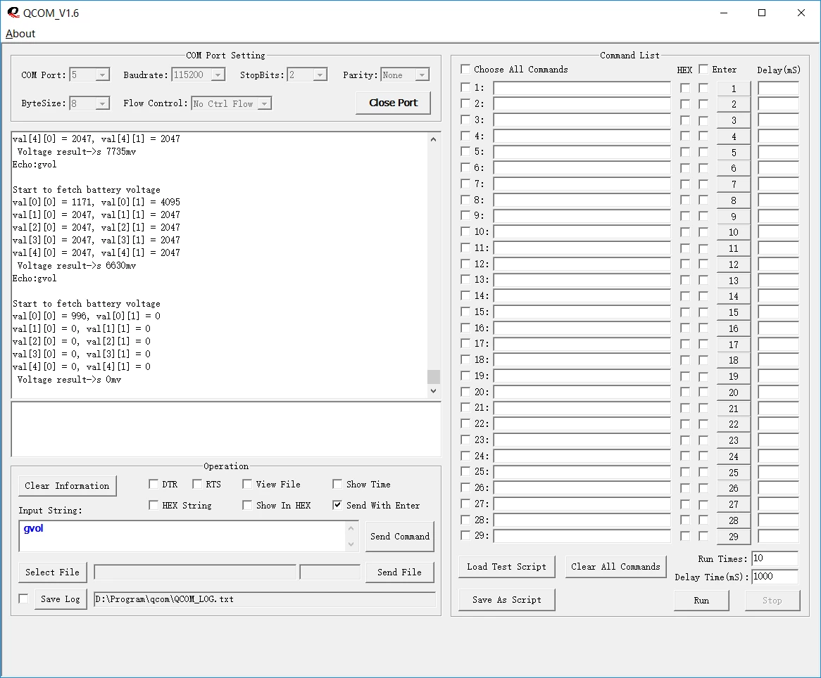

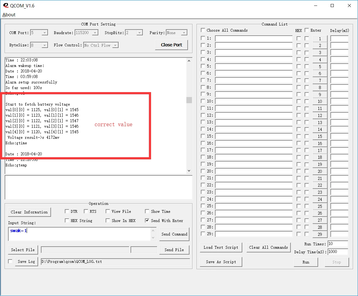

    Apr 29, 2018 8:44 AM UTC
    Posted on April 29, 2018 at 08:44
    I have print all ADC and DMA register before and after wakeup, no any finding. following is the output of ADC & DMA register values comparation before and after waekup from stop.
    I am suspecting  whether this is a STM32L071RB chipset bug now.
    Start to fetch battery voltage
    val[0][0] = 1671, val[0][1] = 1536
    val[1][0] = 1673, val[1][1] = 1535
    val[2][0] = 1675, val[2][1] = 1536
    val[3][0] = 1674, val[3][1] = 1535
    val[4][0] = 1671, val[4][1] = 1535
    Voltage result->s 4144mv

    Echo:gvol
    val[0][0] = 1669, val[0][1] = 4095
    val[1][0] = 2047, val[1][1] = 2047
    val[2][0] = 2047, val[2][1] = 2047
    val[3][0] = 2047, val[3][1] = 2047
    val[4][0] = 2047, val[4][1] = 2047
    Voltage result->s 6630mv

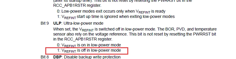

    thanks all of person's help, finially, I found the fix. if I enable ultra low power mode, this issue disappeared, although I don't understand the real reason.
    HAL_PWREx_EnableUltraLowPower();

    Has anyone found a solution? In any configuration if we enable ULP, after STOP wakeup the vref seems corrupt.
    JWieb
    Oct 30, 2023 5:04 PM UTC
    @dz huang
    Try disabling the ULP before ADC calibration and enable when you are done with the ADC.
    This worked for us:
